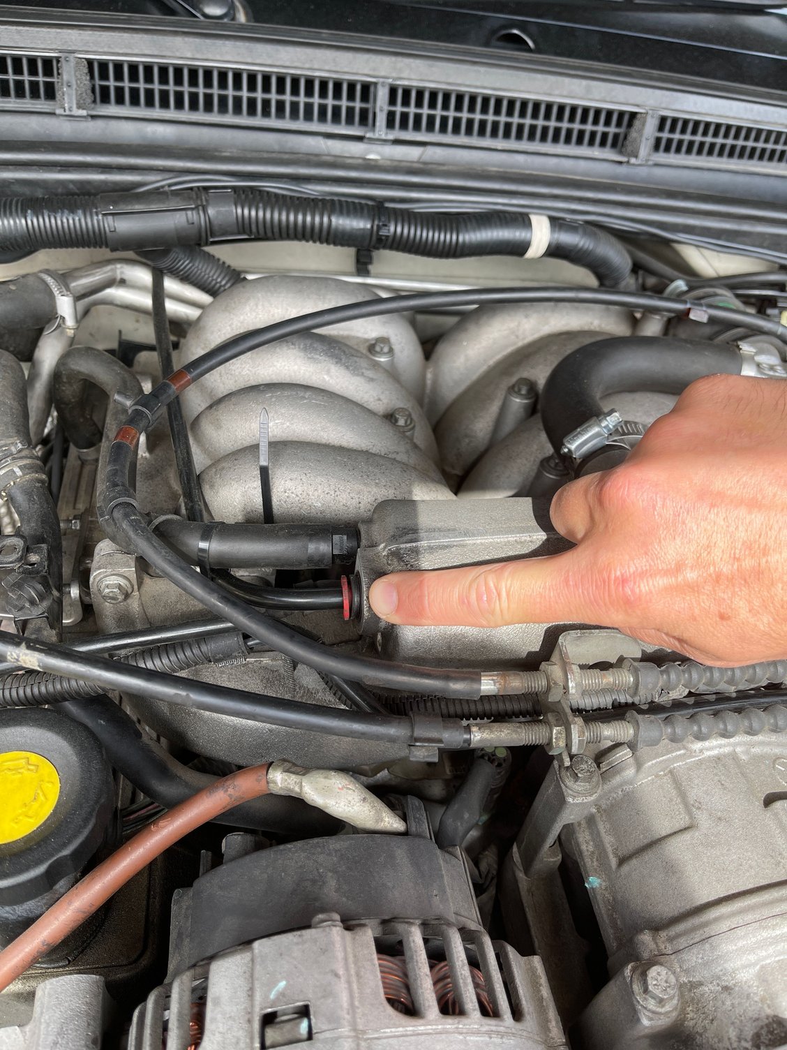

is the hose you are referring to?

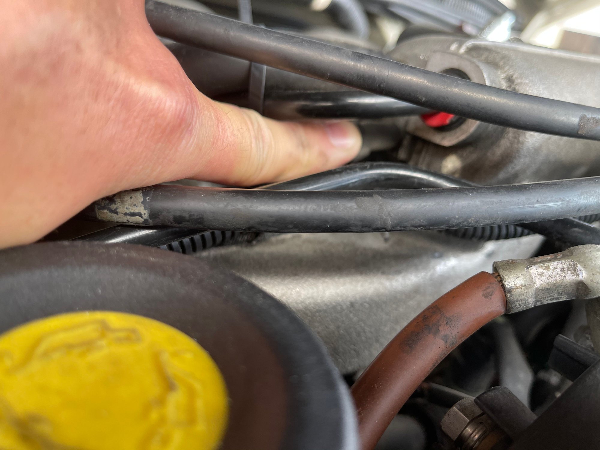

I would say I’m a novice at best but I’m trying to figure this out, where would I find such air intake line? Do you have maybe a picture or parts diagram?

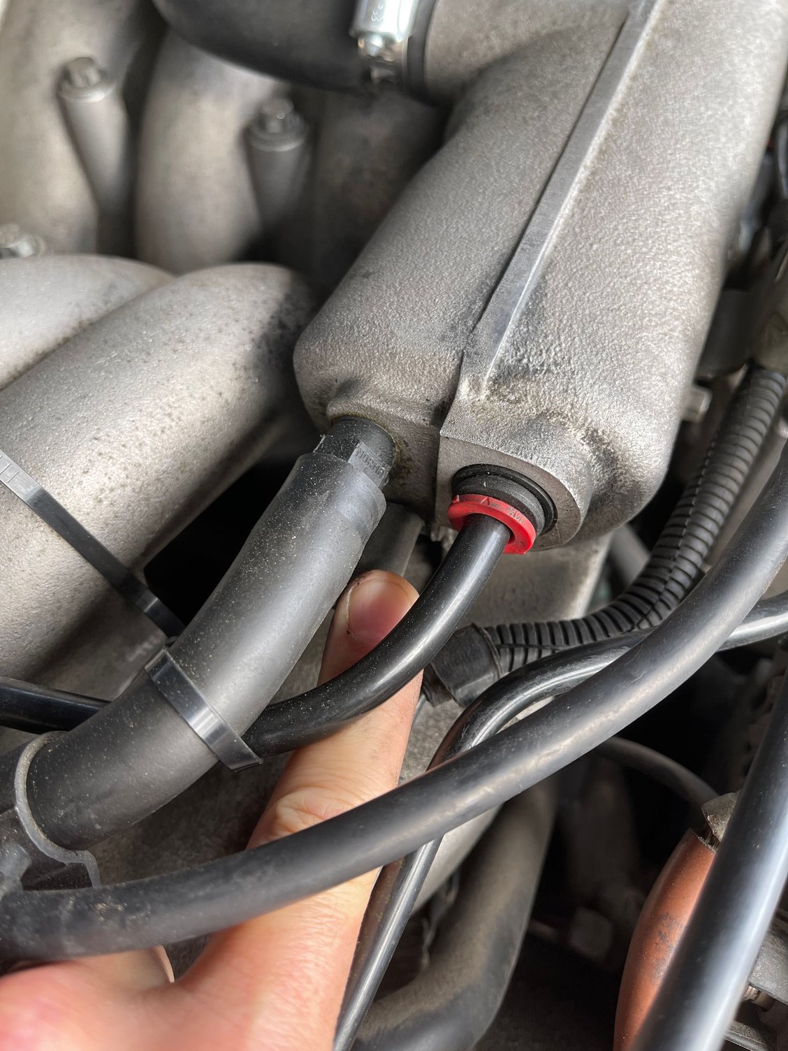

The one with the red ring you are pointing at is for the brakes. The nipple you are looking for is right under that.

I’m not seeing a nipple directly below it that I do see one below it into the rear of the vehicle as depicted in this picture. With the smoke machine plug into the line or into the intake manifold?

That's weird, but okay. You can remove the hose that is to the left of the line with the red ring and use that to blow smoke into the intake. That'll be fine too.
But be careful with that feeling. The original one is a plastic that is known to break. If you do break it, you can get a brass replacement at any Lowe's or Home Depot or somewhere store. In the plumbing section.

ok got it thank you. Just to confirm you’re referring to the PCV valve correct?
I have seen other post about that being a easy part to break and what to do to replace it if it does.
