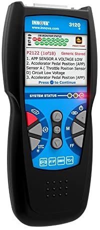

I have an OBD reader, I'll see if that shows me some codes. I have this one:

You need something that can read the Land Rover ABS codes.
