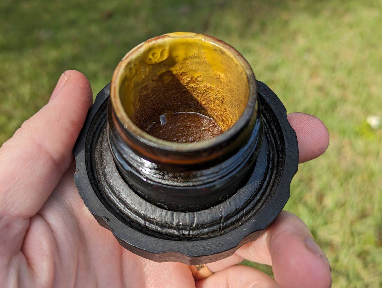

Ok, I was able to verify that my fan seems to be OK. It does not wobble or spin freely, and appears to create a healthy airflow across the radiator. I picked the expansion tank up as far as I could and broke off the plastic line coming from the throttle body heater. I live in Florida, so I did an impromptu bypass. I poured in ~1 quart of distilled water until the glugging stopped, and started the truck with no thermostat. It was fine for 11 minutes until the temperature jumped from ~190 to 220 and I shut the engine off. I had the cap on less a full turn, as suggested. My Kobalt infrared thermometer only showed 106F at the thermostat housing, but a decent quantity of water was expelled from the overflow hose at the expansion tank, so I don't believe that number. I couldn't get good readings at the radiator, either, unfortunately. When I saw 220 on the scangauge, I immediately tried to rev the engine to see if the temp would come down, but it didn't move.
About 30 minutes after shutting the truck off, I thought to check the oil. I opened the fill cap, and saw this:
Panicking, I drained a bit of oil from the pan, and saw this:
That actually wasn't as bad as I thought it was going to be. So do I have a small leak in my head gasket? Do I need to borrow a boroscope and start pulling sparkplugs? Or am I still chasing a waterpump? I don't believe the head gasket has ever been replaced, so I won't be surprised to learn that it's bad after 145k miles, but I don't want to jump to such an involved repair if something else is actually going on.

I borrowed a compression gauge from a local car parts store, and completed a compression test on the left bank before it got dark. Cylinders 1 and 3 both showed 150 on the nose. Cylinder 5 only got up to 115, and #7 got up to 130. So I don't think that looks very promising.

115 is a little low. Cap does not look great. I would trust the IR, did you feel the hoses with you hand? I suspect you have the beginning of a blown hg, some exhaust gas is getting in the coolant and causing a spike in the temp sensor reading but the engine is not actually hot. The engine, oil, coolant and all the components have a lot of thermal mass and the temperature cannot change suddenly but the sensor reading can change suddenly if there is a vapor pocket. Vapor pockets don't damage the engine, getting the entire assembly way up over 230 does. Suggest you rent/borrow the cooling system pressure tester from Advance and warm the engine up, then subject it to a pressure test and see if it can hold pressure. If it does not, you either have a leak or a blown hg.
