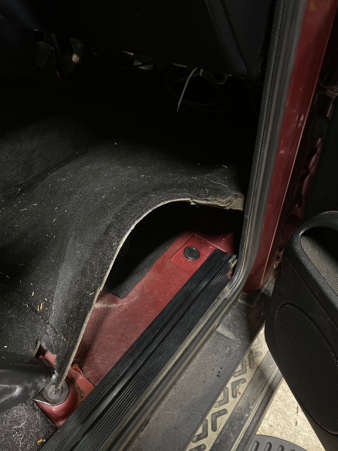

Currently chasing down passenger floorboard floss. Does anyone just remove this body plug as a means to attempt from water building up??

OK, so you really want to fix this problem properly instead of just draining it because it means that water is running down either your B pillar (seat belt area) or your A pillar by the windshield. The leak most likely is coming from a broken sunroof drain, so drop the headliner and fix it or (as I did for several years) seal up the sunroof. A big risk here is that water is draining down your front A pillar over the BCU and ECU (the computers) and associated wiring and is wreaking unseen havoc.
It could also be coming from a plugged AC drain tube on the passenger side, I had that happen as well. We were in the middle of a road trip during the summer and my wife told me the floor mat was wet despite driving through dry, hot terrain. At our next stop in Billings, MT I had to buy a wire bound notebook, strip out the wire and get underneath to unplug the drain line at the back of a Walmart parking lot!

@Randy Copeland I have not but I have rubber floor mats. Try this though a good sized piece of cardboard and put in the passenger well supported in a couple pieces if 1x1. If the cardboard gets wet it is dash/windshield other wise pillars etc.

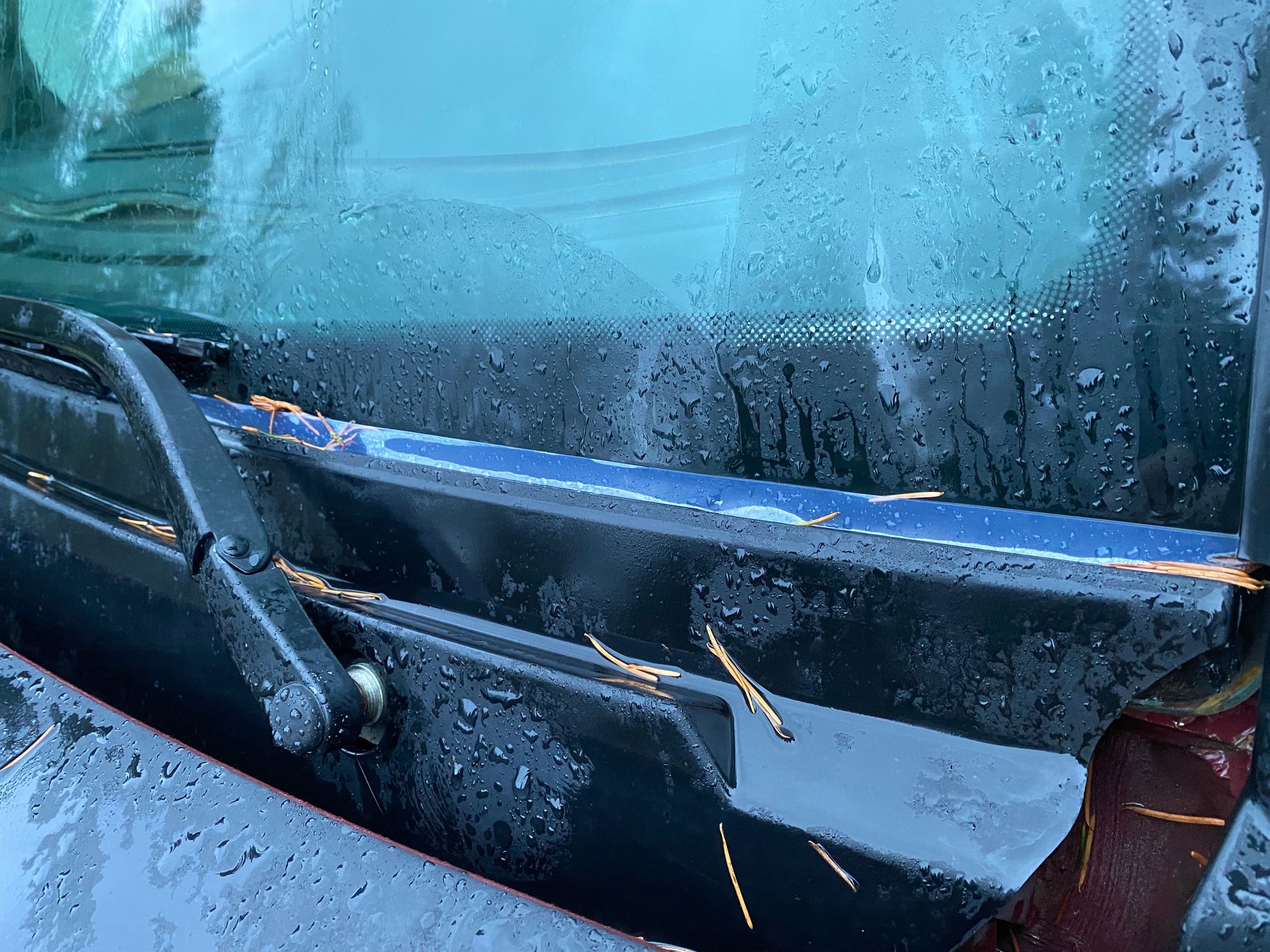

Thanks for the input! I think I have solved the issue…. For now! The only place I hadn’t addressed was the lower windshield seal and the fresh air intake. Any water SHOULD have drained out the large holes on the sides.
I fashioned a seal out of bathroom shower silicone from Amazon, and made a fresh air intake cover (top half only)from an empty antifreeze jug, and sealed it with a bead of silicon. Happy to report no water in the floor despite the Pineapple Express!!
Thank you all for your help, maybe this will pay-it-forward and help someone else
