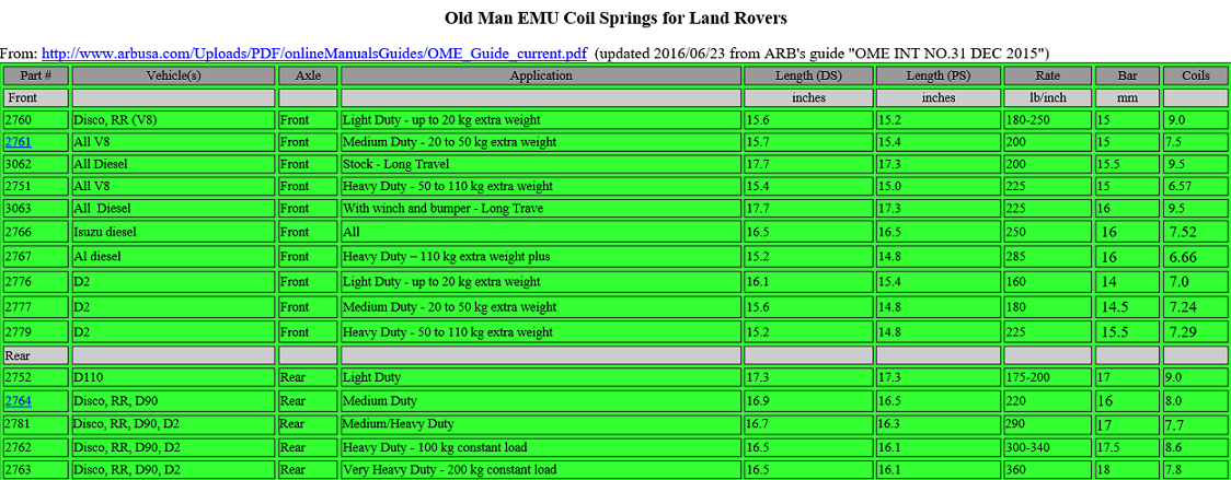

This might be helpful re: coil heights and load ratings.

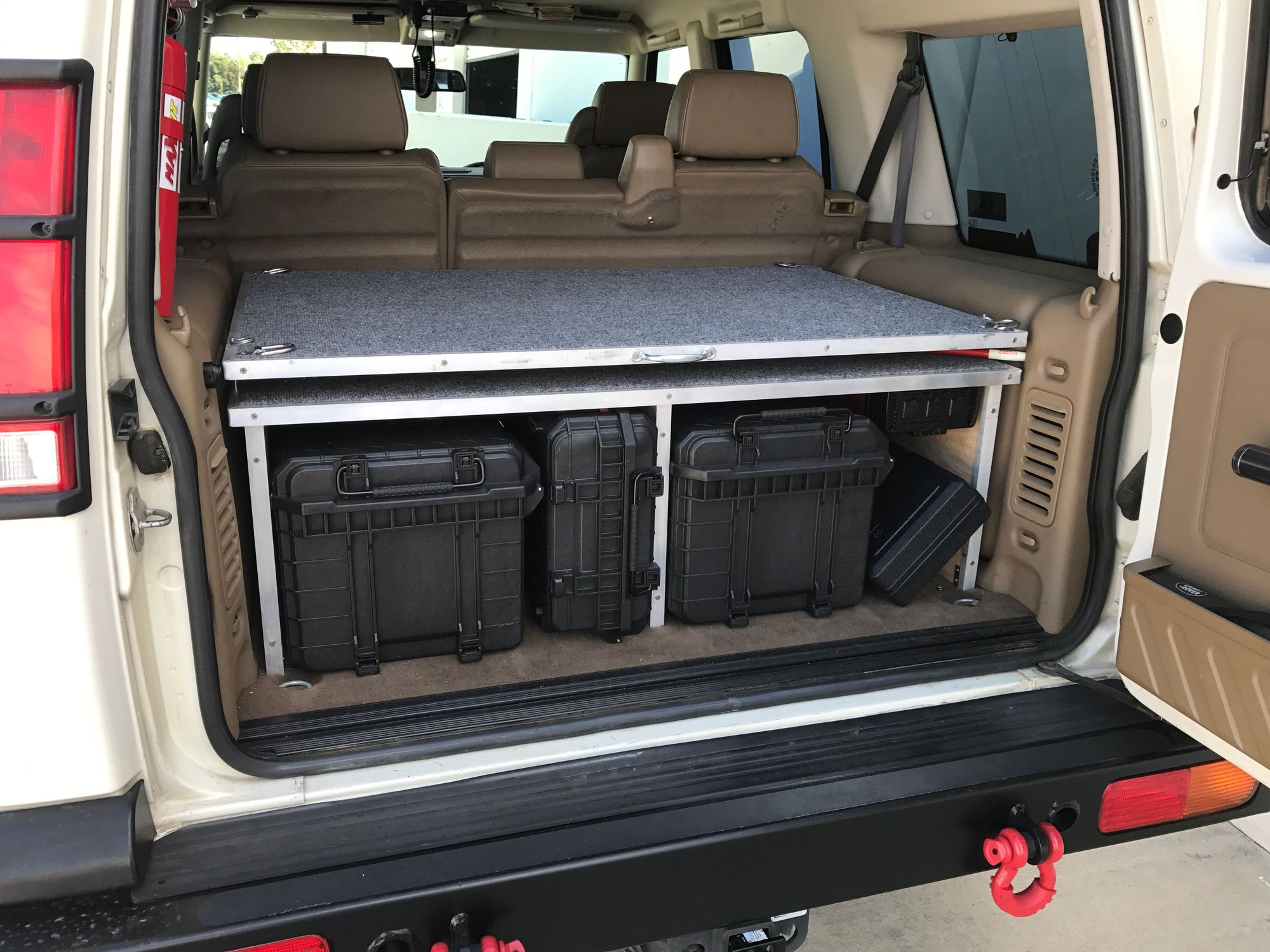

Steel front and rear bumpers with winch, sliders, HD steering skid plate, HD gas tank skid plate, roof rack, custom storage in rear cargo space (shelves, boxes, etc).
Front: Terrafirma TF052 HD springs, TF118 HD shocks
Rear: Terrafirma TF027 HD springs, TF119 HD shocks
No sag, so far. 4,000 miles.

Truck rides great. Bigger tires and stiffer suspension make for a bit bumpier ride, and the extra weight up top causes a bit more body roll (also added a new BajaRack up top which is a bit heavier than the old one). I have quick disconnects on the front and rear anti-sway bars (visible in pics), and keep the bars connected about 99% of the time. Then again, it's not a 2020 HSE so a more truck-like ride is just fine with me. 2 years now on this setup, and still no complaints.
