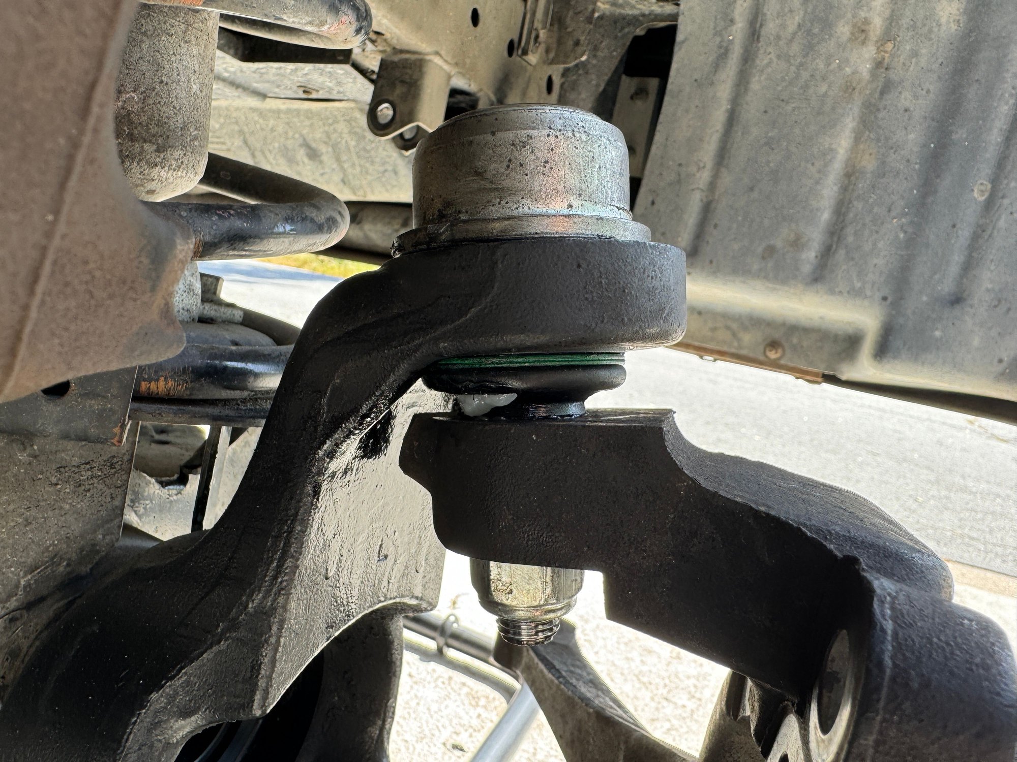

Last nut to torque down on the ball joint replacement project and turns out one of the boots had a tear in it. Are new boots an option? Seems silly to have to press this one out, order a new one, etc. when this joint is perfectly good.
EDIT: Doesn't look like new boots are available. Current plan is to order a new ball joint and just transfer the boot from that over to this so I don't have to re-press new joints.

I don't know of any oem-like rubber boots, but https://polyboots.com/ makes polyurethane dust boots for ball joints. You just need to know the size. I've had them for my steering bar tie rods for a few years without issue.

tear probably happened as you pressed it in. almost pinched mine when i installed new ones last year. those top ones can be tricky

I had same problem. Local shop pinched one. I just used silicone tape and said F it. Last ones lasted for years with cracked leaky boots. I replace it again in 10 years....

really not as critical as people think. One of mine has pretty much all 4 boots torn and is still rock solid and I've owned it for 8 years and has been used hard.

I agree. Drove a Disco 40K miles and 5-6 years with all 4 boots totally missing (but joints good). When I sold it, they were still good. My current Disco has a missing boot on 2 joints, and I'm leaving them alone.
