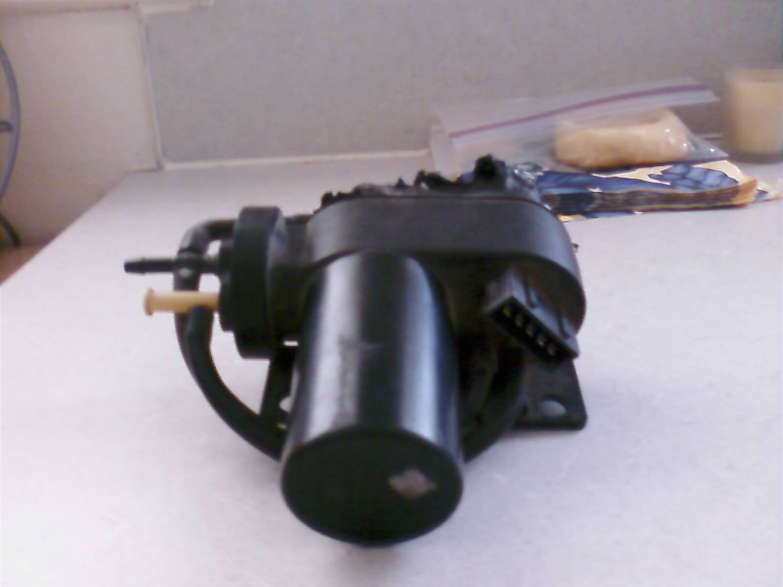

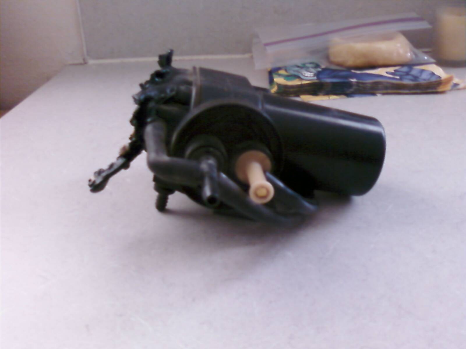

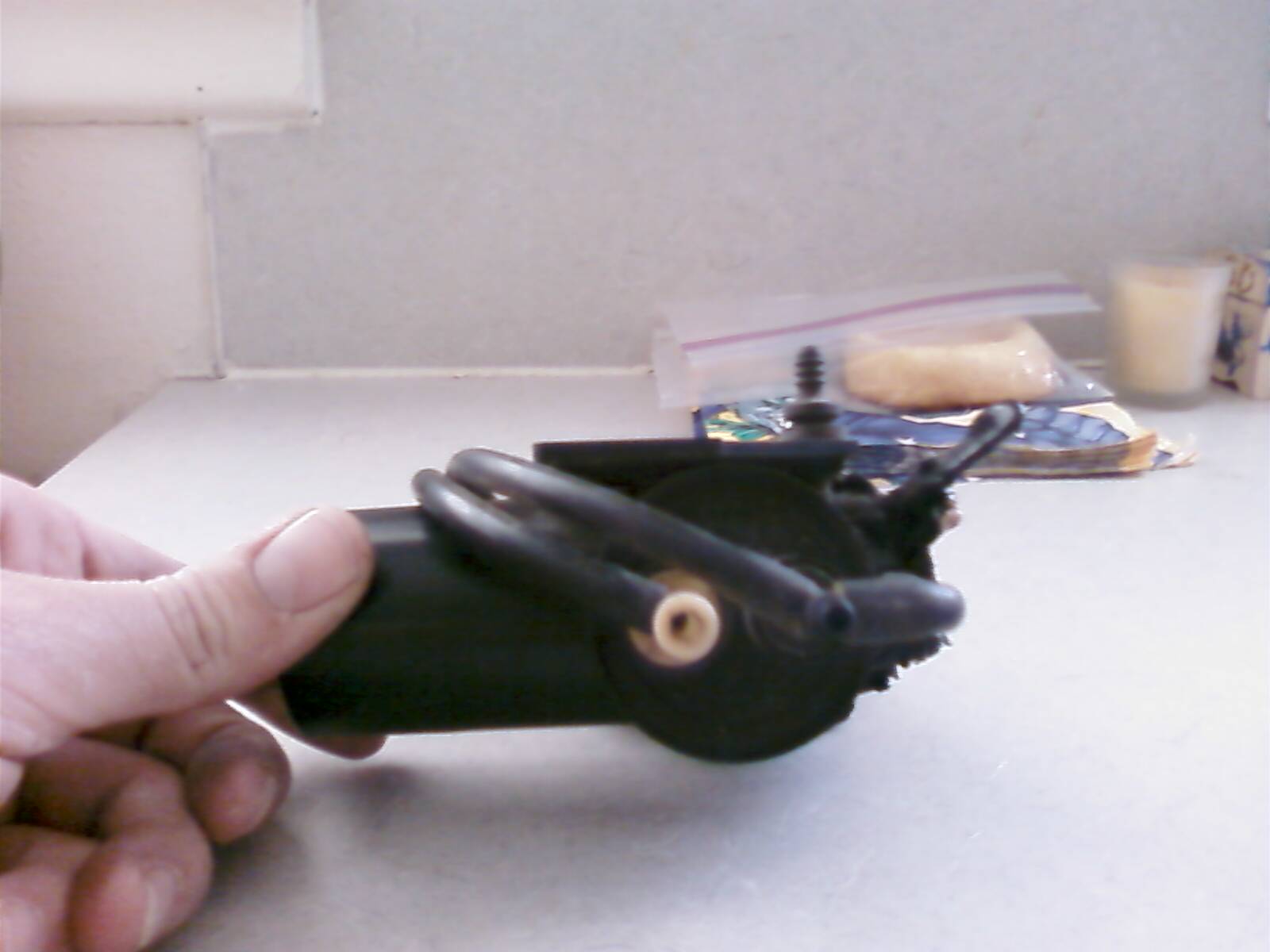

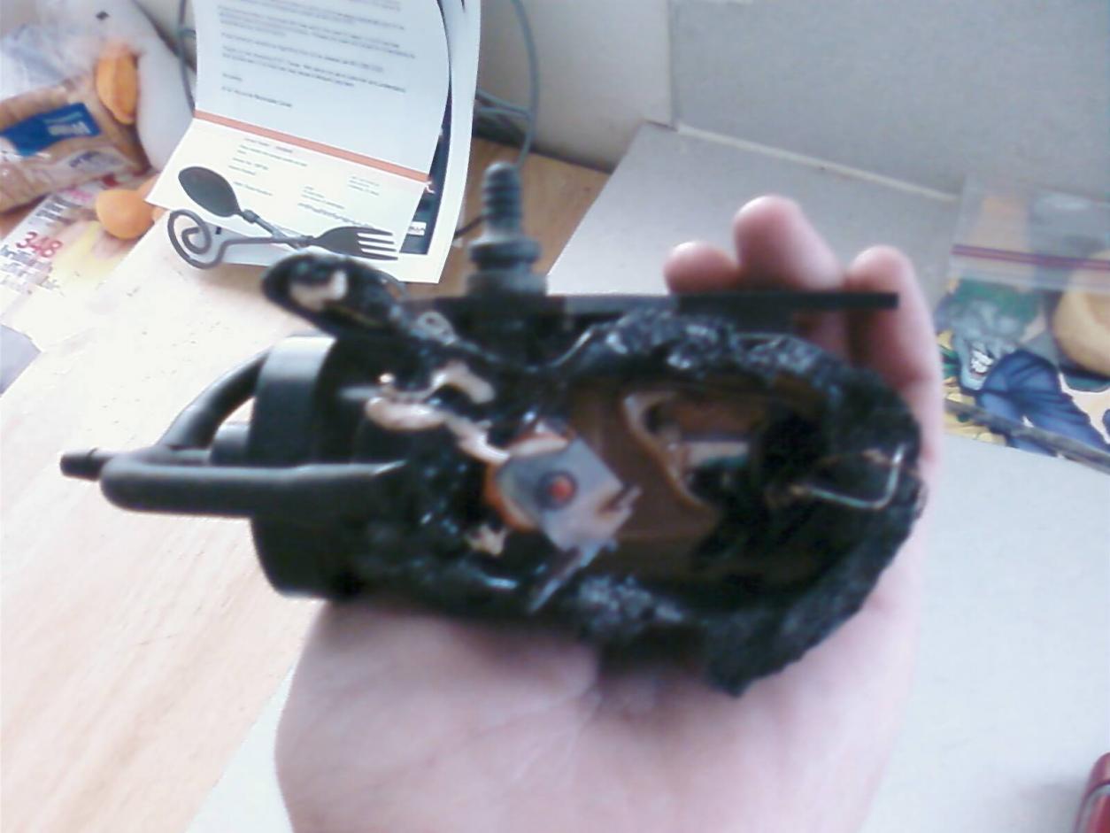

Alright guys, I checked out everything I was suggested and was looking under the hood on the passenger side and found this burnt thing with a wire haarnest and vacum line. I think this is why I cant shift out of park, I hope anyways. Does anyone know what this is, so I can order one. Ok how do I put pics on here?

Default Maybe this is it.

thats your cruise control pump

could it be the cruise control pump since it has melted?

If so does anyone have one for sell. I'll take a used one or anything else you got. I have checked all fuses under dash and under hood. All fuses are good. I found the melted cruise control pump while I was looking for bad fuses. I think it maybe th e prob. But I will wait and see what all y'all think

Was it mounted in the front near the left headlight? I was wondering what that was. It is hard to believe that it could melt that badly and not blow a fuse! To draw enough current to do that much damage and not blow a fuse would indicate that it is on an unfused circuit. And I really doubt that is he case. Check out the electrical section in the RAVE download and I think you will find the entire circuit detailed there identifying the fuse rating and location. There is also a section for component locations. Get used to looking at it if you plan on having your Disco long.
