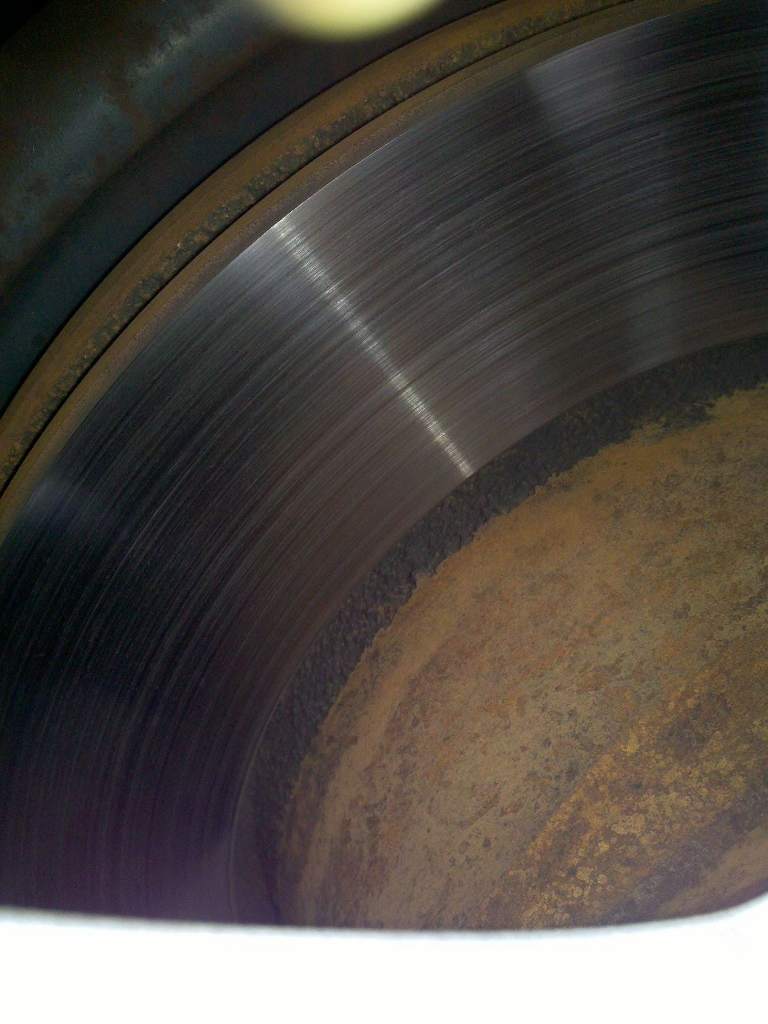

Hey Mike,
Do you clean those things? My rotors, which I've changed only a few weeks ago, already seem to have some oxidation forming. Especially the front in that space between the two "layers," if you will.
-Anthony

I have only cleaned them with brake cleaner once, when I installed some new pads. I do power wash them if I get in some mud, thats all. Can you send a picture so I can see what you are referring to?

Originally Posted by Disco Mike
... Can you send a picture so I can see what you are referring to?
This is what they looked liked when first installed (August 30th):
This is what they look like today (27 days later - no off-roading):
Normal for these generics/standard rotors? I used this rebuild kit from AB:
Land Rover Discovery II Brake Rebuild Kits: Land Rover Brake Kits Online
-Anthony

That is rust, does the truck for days, if so that is why they are rusting.
