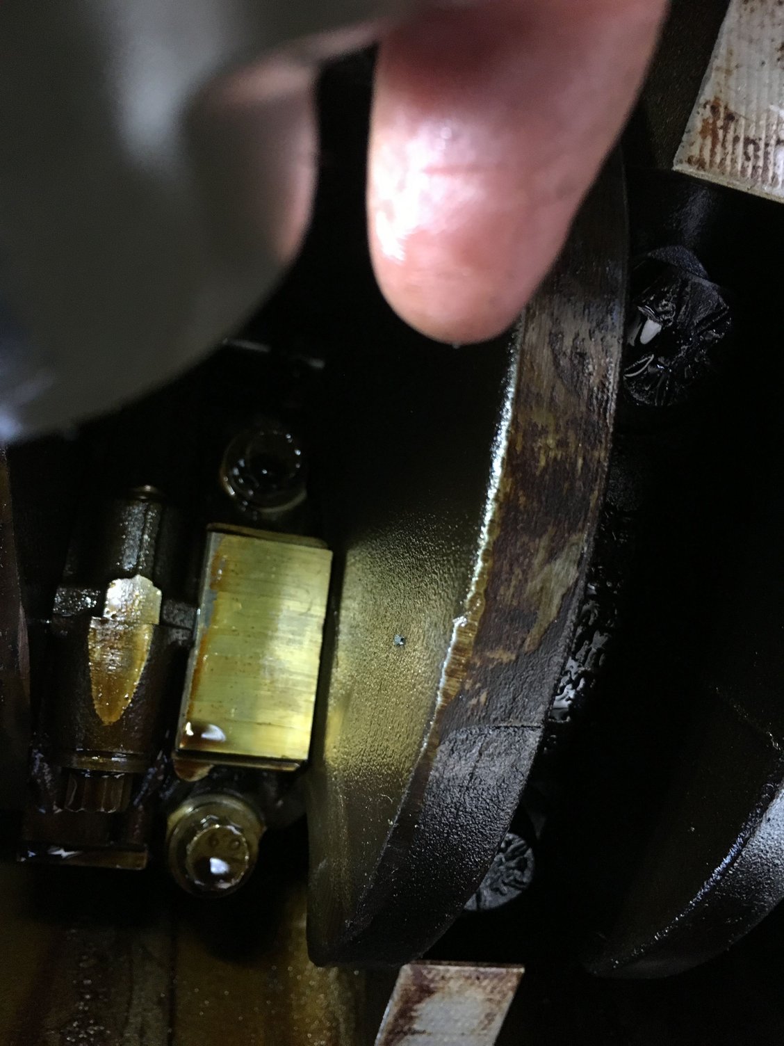

Had the oil pan off and took some pictures of this wear. Have another post I’m putting up, but taking 20w50 oil and heavy duty lucas oil stabilizer to keep oil pressure up at hot idle, and, probably separate problem, huge misfiring cylinder at idle. But what is this wear from?
Notice the lighter brown colors, left to right. Left is slightly shaved off metal.
The edge is ground down and jagged. What is this rubbing against?

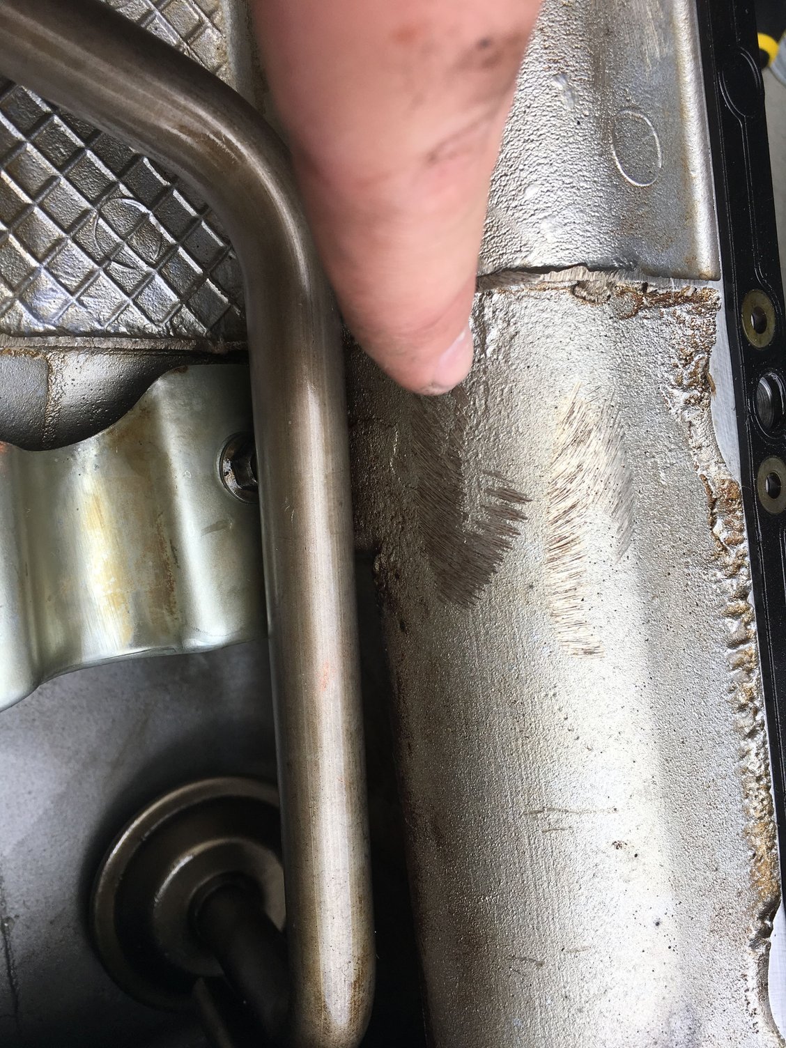

This mark is inside the oil pan. Could this rubbing be from those parts in the engine? I’m so ignorant I don’t even know what those parts are called.

that all just looks like marks made during production of the engine parts such as removing casting "flash"ETC.

Those are the marks of a grinding wheel on a hand held power tool, probably wielded by a drunken British fellow producing **** LR V8 motors that will later all blow up in our vehicles. Bless him.

So all that wear is "normal"? That's encouraging! I got a good visual of that drunken British fellow, love it.

I’ve been watching engine explanation videos today and finally got my answer on those engine parts: Crankshaft counterweights are what I was seeing that wear on. Fantastic short video by engineering explained of a V8 engine, using a 3D printed model—
