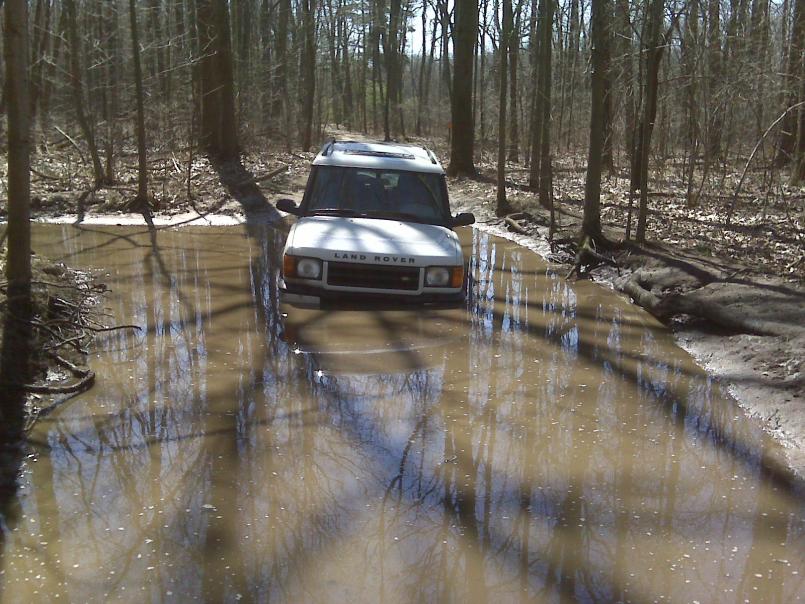

I went cruising the trails in the allegan woods with my 2000 D2 two days ago, had a great time until we came to about the 20th mud hole and found out the water was a LOT deeper than the other ones. I found out there were deep ruts under the water, so we wound up getting high centered. It took about 45 minuits to get it yanked out and in the mean time the water got about 4 inches deep on the drivers side. When I drove it home I noticed it was always in 3rd gear as far as I could tell, I assume that means no power to the tranny. When I got back to the house, I turned off the key and pulled it out of the ignition only to discover it kept running! As far as I can tell it shut off the fuel pump, but nothing else, so it would run until the pressure dropped in the fuel system. All of the warning lights on the dash are lit with the key removed also. I was totally booked the last two days so I just unhooked the battery.I went back out there tonight and the tranny is still acting up and all the warning lights are still lit with it off, but the engine will shut off now. So, any ideas where to start? how in blue blazes did swamping the thing make it do the crazy keep running trick? If it blew fuses or wouldn't run that would make sense, but keep running with the key out? Nuts.

If I have this attachment thing figured out, here are some pictures of the "dive".

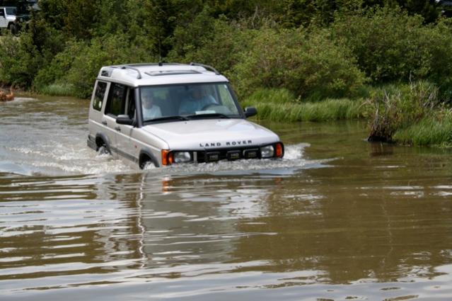

A D2 would easily have made it based on that picture.
My concern is that depending on how much water you took on and how wet the total electrical system got, many people/insurance companies have to total the vehicle because of the long term corrision issues that will come up for months afterwards.
I have done a number of water crossings, good safe rule of thumb is water to the tops of your tires and you should be fine.
Attached Thumbnails What happens when you swamp the floor in a D2-img_2433.jpg

You are absolutly right, what got me in trouble was the fact that so many people with taller tires had been through there before me. The disco literally had two wheels that weren't touching bottom, it was setting on the frame and axles.
As far as what got wet, it was isolated to the wiring going to the tranny and what ever is under the drivers seat. It was sloped heavy to the drivers side so nothing on the passengers side got wet.
