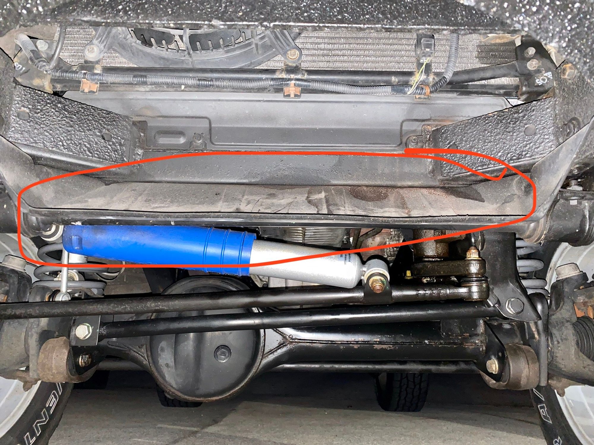

So this funky scoop thing can be removed?

That is left over from the OEM front bumper. It helped to direct air up thru the radiator, but once the OEM bumper is removed = it's pretty much useless.

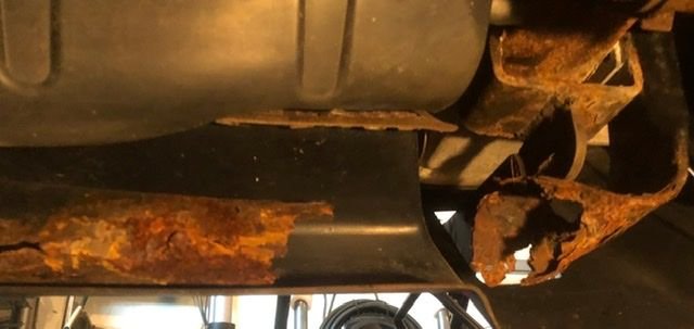

Lol, heres what it looks like if you live in New England

Just a little surface rust. Nothing to worry about!
