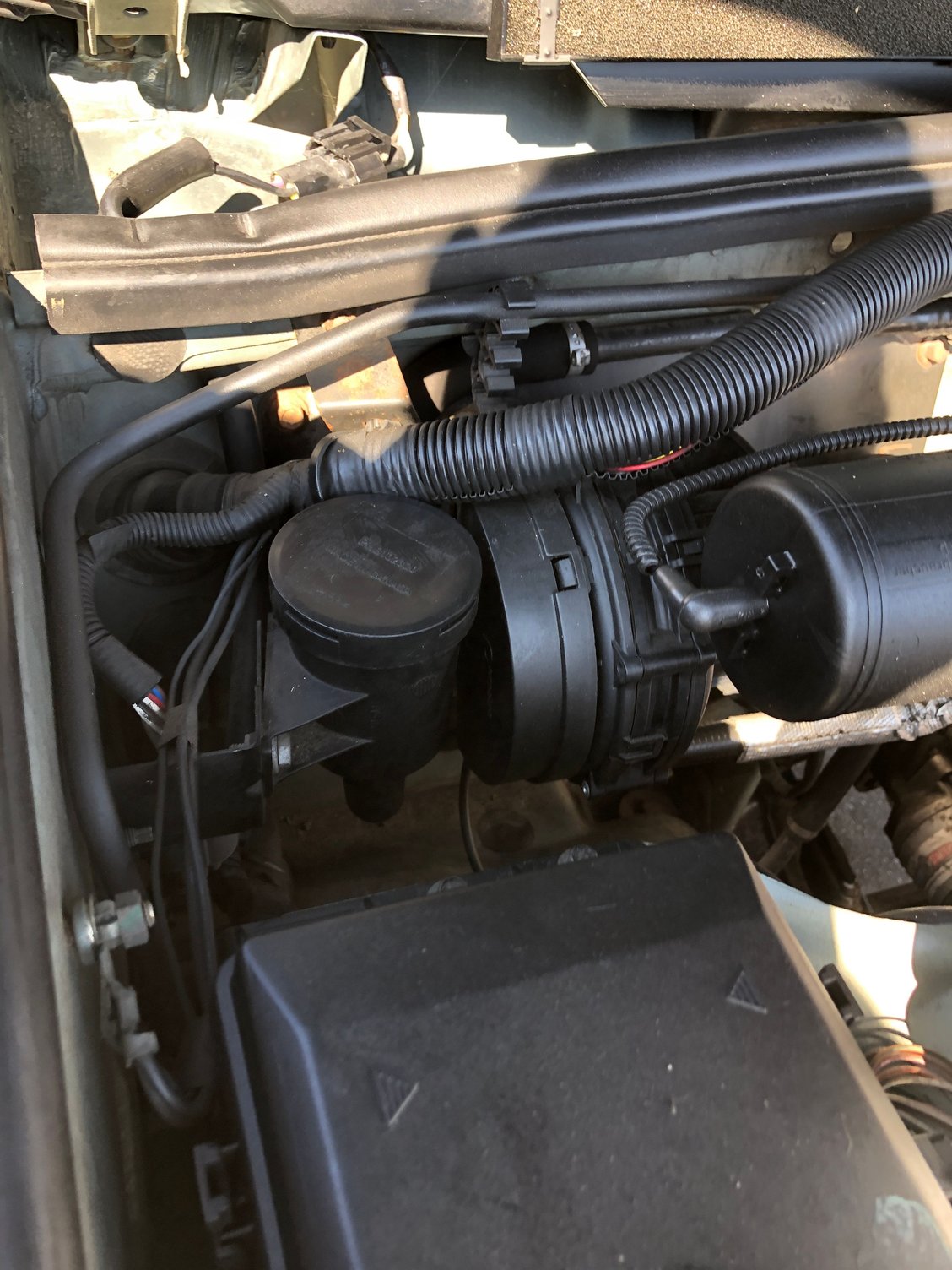

Was under the Disco today and noticed whatever hose this is connected to is leaking back near the rear driveshaft area. The hose runs from this canister, along the frame rail toward the back of the car where it terminates into some kind of valve-ish looking thing alongside a mess of hoses.

Is this a differential/drivetrain breather kit someone installed?
What is it leaking?
I don’t claim to know everything (or anything really!) but don’t recognize this part.

That's the filter for the fuel leak detection pump. RAVE page 17-2-25.

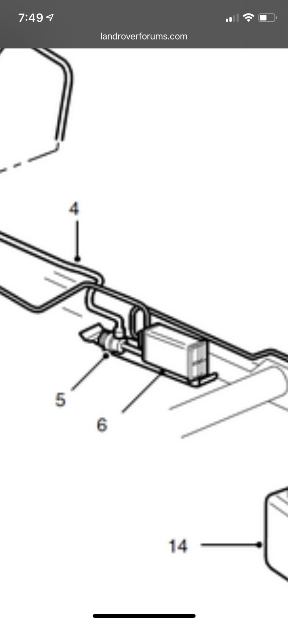

As mollusc said, the component you pictured is the fuel leak detection pump filter that is described on page 17-2-25. The full system of which it is a part is shown in a diagram on page 17-2-4.
It seems you likely misidentified the line you say is leaking. The line from the filter canister runs to the leak detection pump, which connects to the EVAP canister.
Perhaps you can instead post a pic or pics of the line where you see the leak.

Haha, very likely I’ve indeed misidentified the source. Fluid is emanating from this unit, and it looked like that hose, but perhaps it’s another in that system? I didn’t think this carried fluid though.
