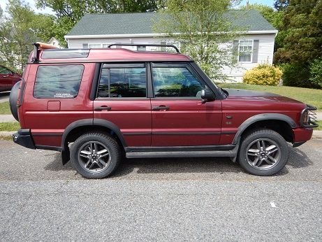

The rear brakes on the Disco were toast, so I decided to do brakes all around while I had it up on jack stands. Figured I might as well hit the rear wheels with a fresh coat of paint while I had them off. They were looking pretty rough with 17 years of road use. Paint was peeling in places, and I just could not get them clean any longer. Amazon Prime had the Duplicolor Paint Shop premix Lacquer at the door the next day. Power washed the aluminum wheels. The hit them with a coarse 3M scuff pad. Shot three coats of etching primer to help fill in the dings and give the paint something to hold onto. Sanded the primer with 1000 grit dry, and wiped them down with lacquer thinner. Sprayed three coats of silver metallic, three coats of metallic clear, and three coats of gloss clear. Buffed with a light polish. Stuck on the new LR caps I bought a few weeks ago. Came out pretty good. They aren't perfect, but they look good from ten feet away.

That looks great, looks almost professional in both the finish project and the amount of care put into the prep.
