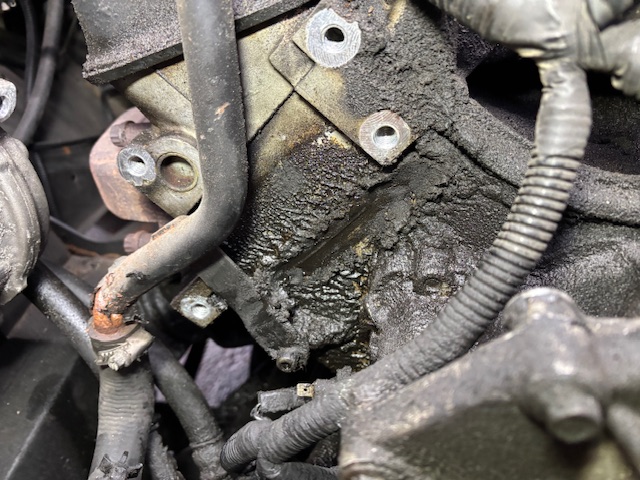

I have an ever so small coolant leak that I cannot figure out. Facing the engine it appears to start where the exhaust bolts on the driver's side, or at least above it. The throttle body heater is deleted (previous owner), and they did a bad job re-routing it, that appears to have some old signs of a leak on the hose, but nothing underneath it. So where else could it be coming from? I'm waiting on an inline thermostat to install (international shipping is fun) so I'd love to get it sorted at the same time.
Behind the ac unit (currently putting in a new ps pump)

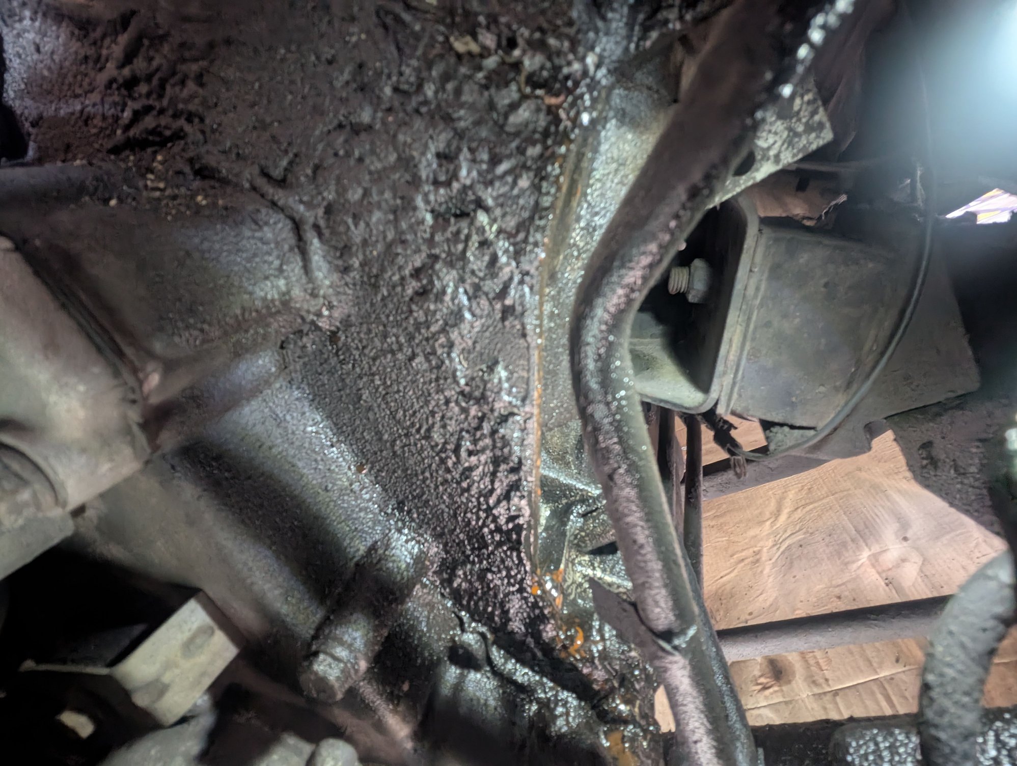

Under the driver side valve cover, quite a way down, coolant. Coolant ends up on the bottom of the transmission pan.
Just above the previous pick. Transmission line for reference.
No signs of leaking from the valve covers imo.

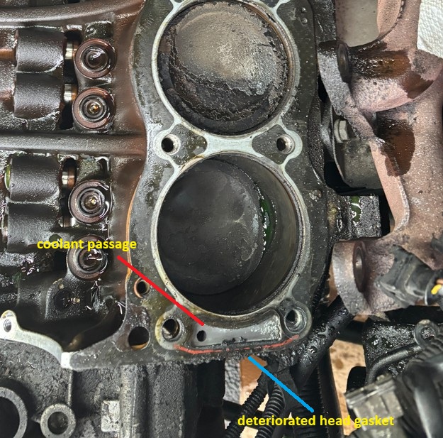

You seem to have an external coolant leak caused by a failed head gasket at the front of the engine. There is a small coolant passage there. I had the same thing and just did my head gaskets.

I have to say that looks pretty similar. I hadn't consider head gaskets as there are no other symptoms. Ugh. How was the job? I think I'm confident in doing it except for getting the heads decked, I have no idea where to even start there...
