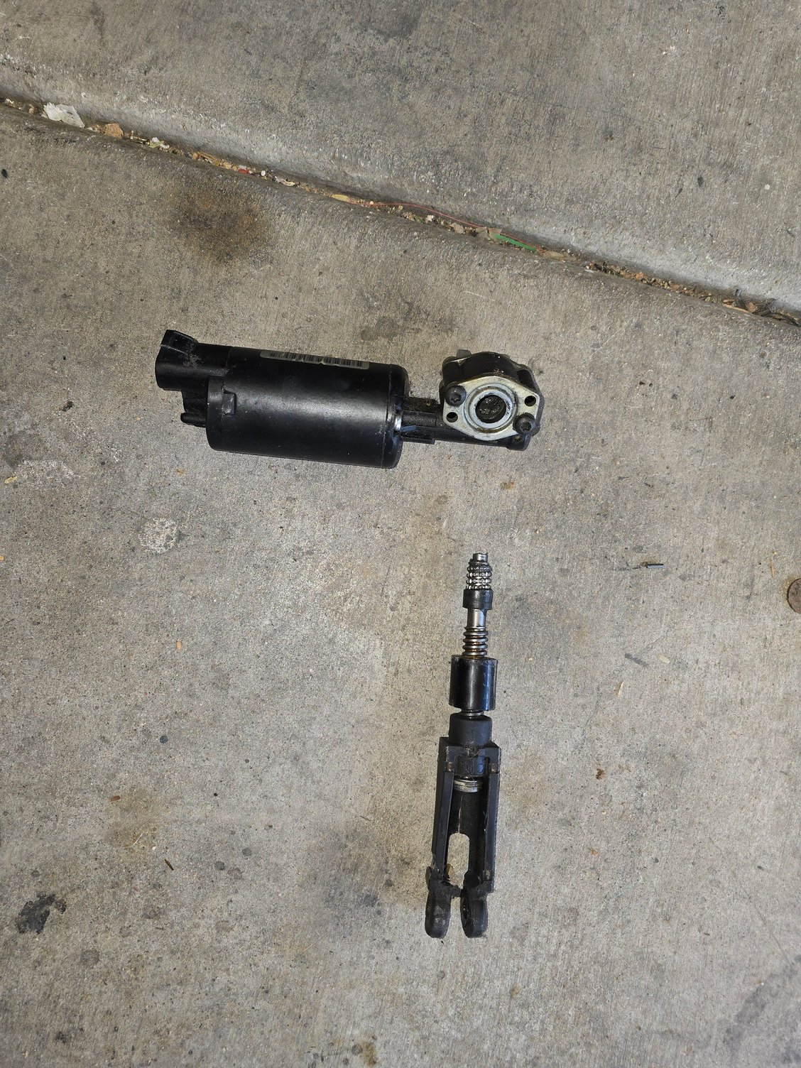

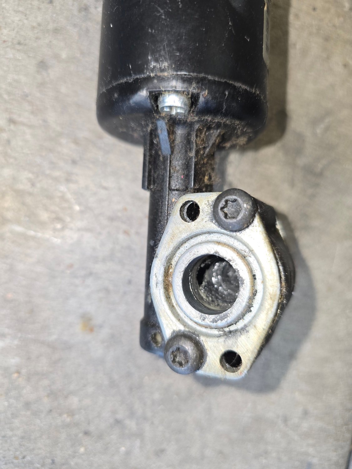

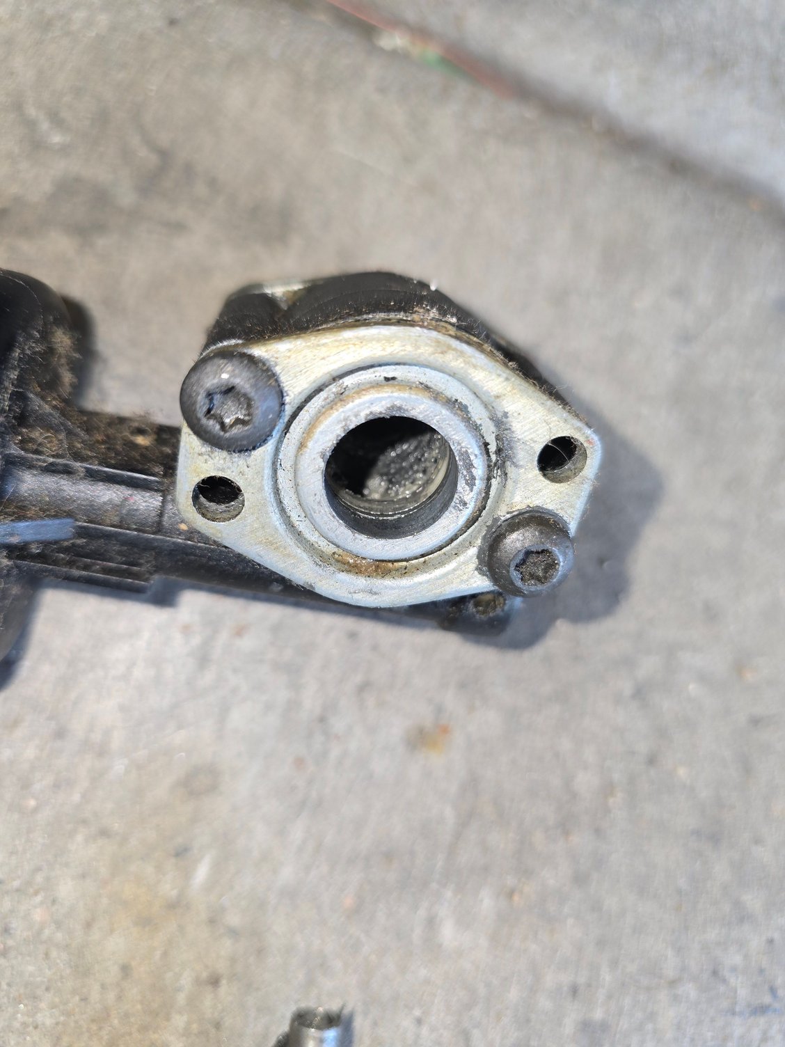

Solved.
The adjustment motor gears were disintegrated. I replaced the motor assembly with a junkyard pull and no more rocking chair.
