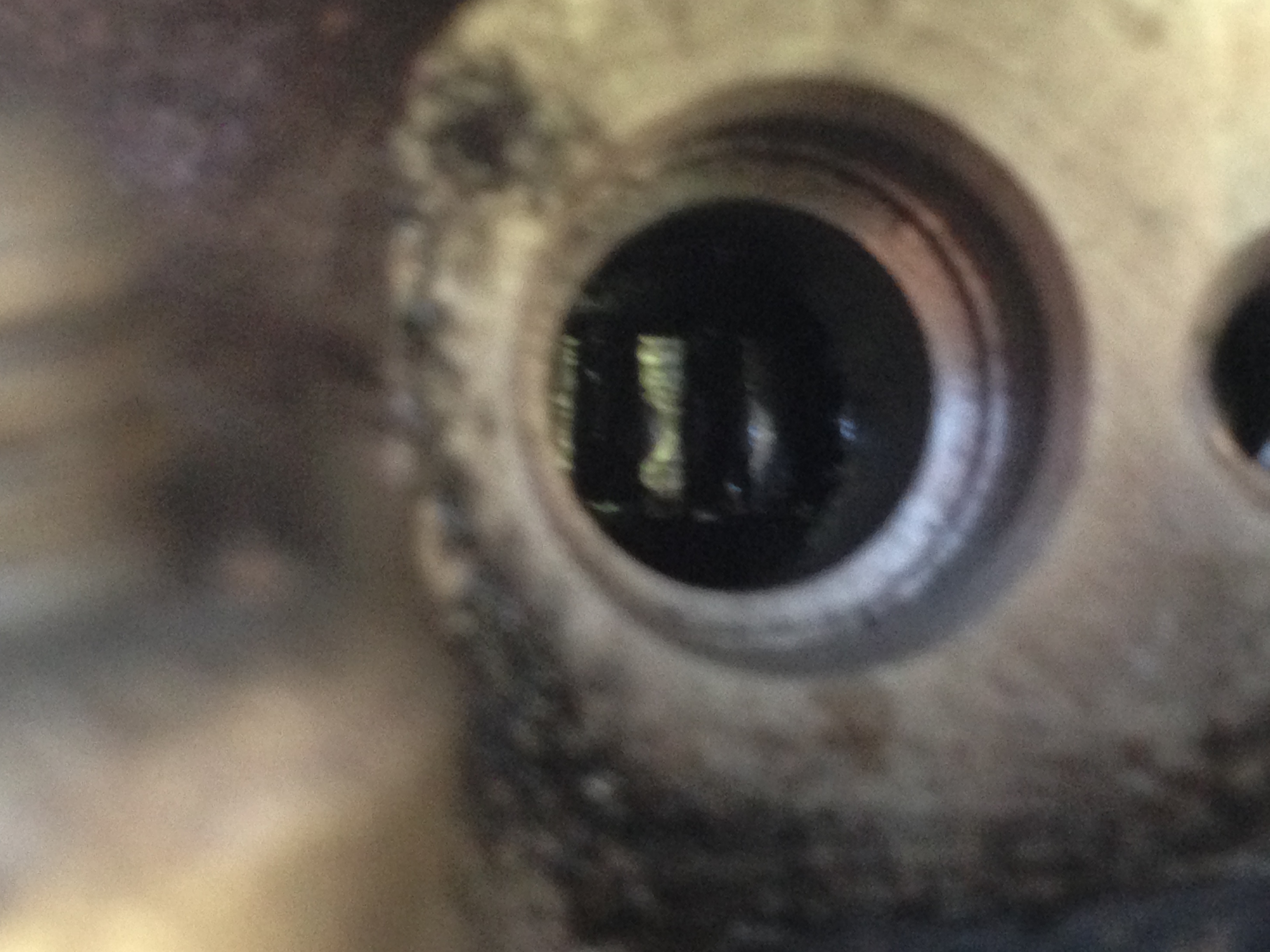

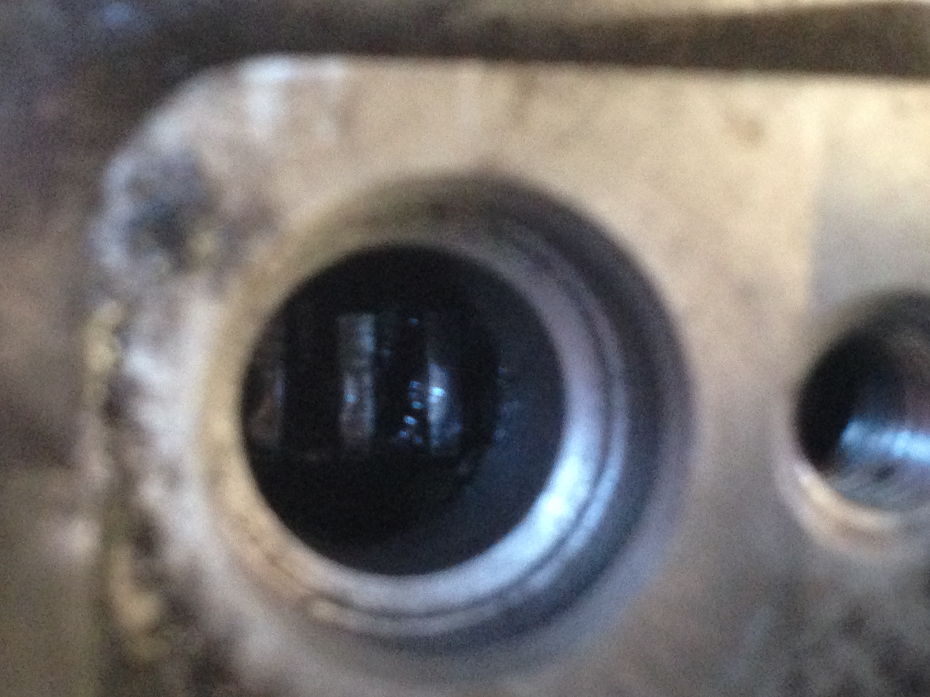

Ok after installing a brand new bearing-sensor combo kit on the right rear wheel, having the 4 amigos reappear after 3 months, then spend the next 9 months looking at the lights (and in a moment of stupidity, replacing the shuttle valve), I finally popped out the sensor, and here's what I found:
Sensor worn down on the end; and
A chipped up reluctor.
As the o-ring was seated properly on the first flange/level of the sensor (if it wasn't then the damage would have been catastrophic), I can only assume that the short cable sensor sent in the kit was a "tad" too long or the reluctor wheel was not precision ground and/or loose or both.
The vendor that sold me the combo kit (who will go unnamed for the moment until we see how this all plays out) kindly sold me a new higher quality long cable sensor albeit at the "sorry 'bout that" discount, I installed it (90% of the effort is routing it along the frame and thru the firewall), erased the ABS DTCs and viola, no more 4 amigos.
Hopefully the issue was the sensor length and not anything with the bearing and that the reluctor still has enough magnetic integrity to it to be functional for several years. Will really not be happy if a new bearing is required as well.
Stay tuned.
Attached Thumbnails Will ABS Option B fix the Three Amigos If Thrown by Bad Sensor Error Code-img_0024.jpg   Will ABS Option B fix the Three Amigos If Thrown by Bad Sensor Error Code-img_0025.jpg   Will ABS Option B fix the Three Amigos If Thrown by Bad Sensor Error Code-img_0026.jpg
