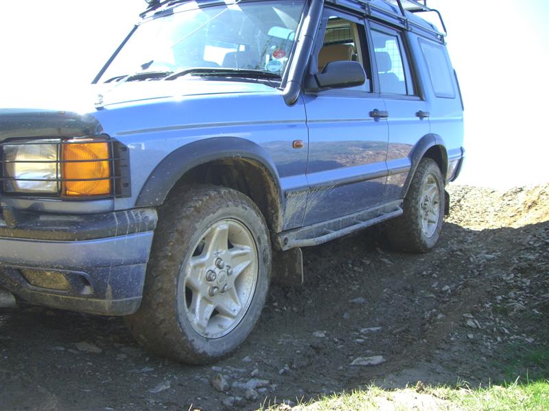

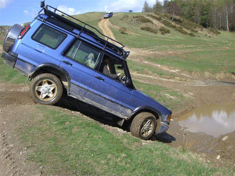

heres a couple of piccys of my sliders with jack points and tree bars that also act as steps to stop the Mrs hanging on the snorkel to get in lol
