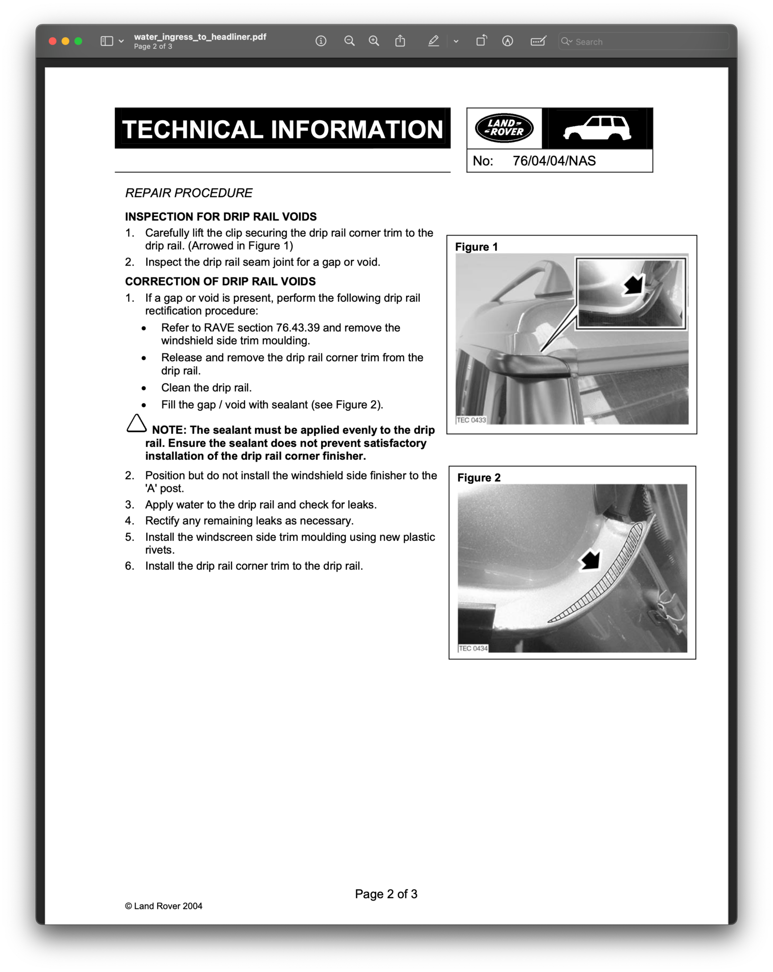

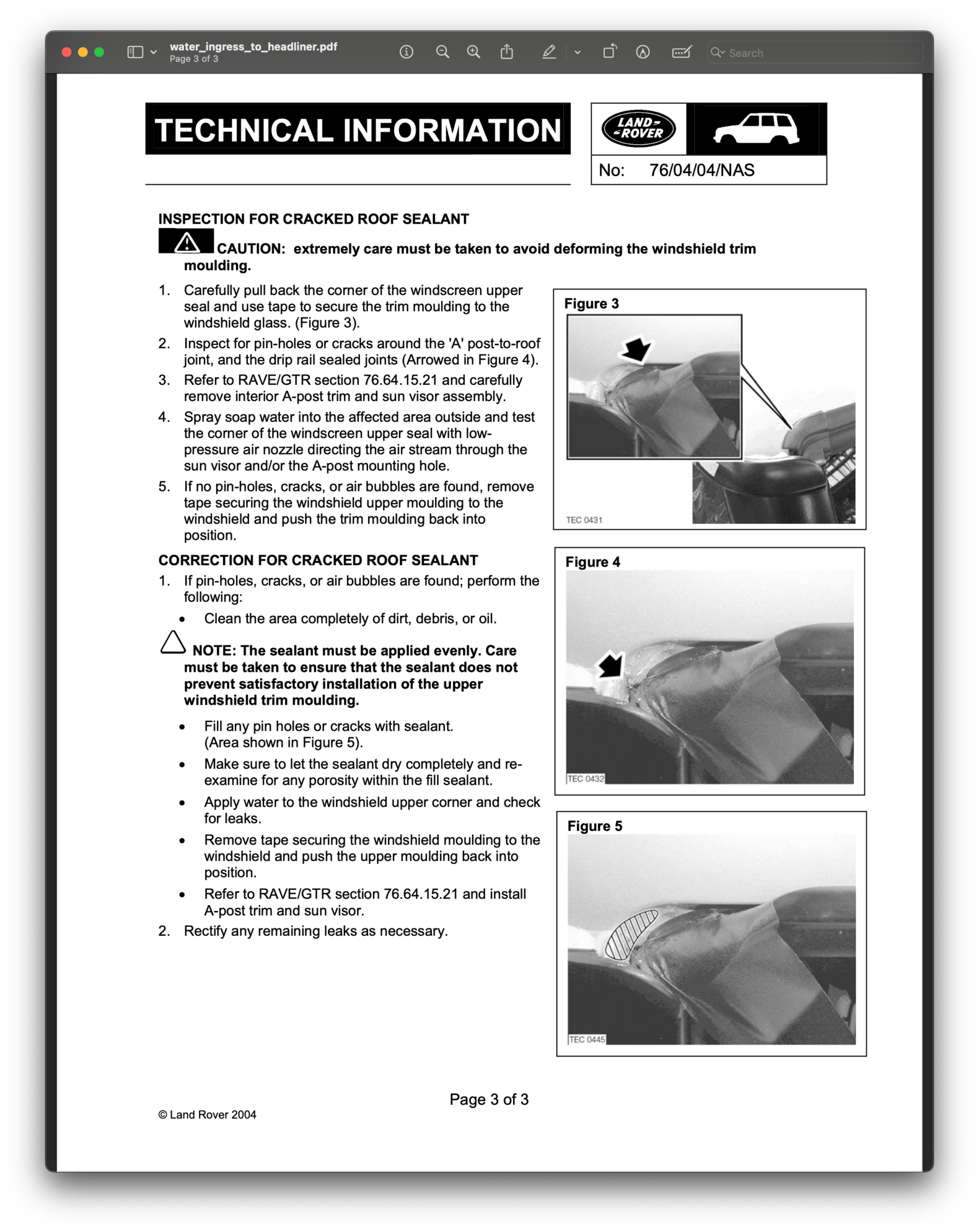

Maybe I'm misunderstanding the issue then. Are you talking about this TSB?

Posts: 16
That’s the one
