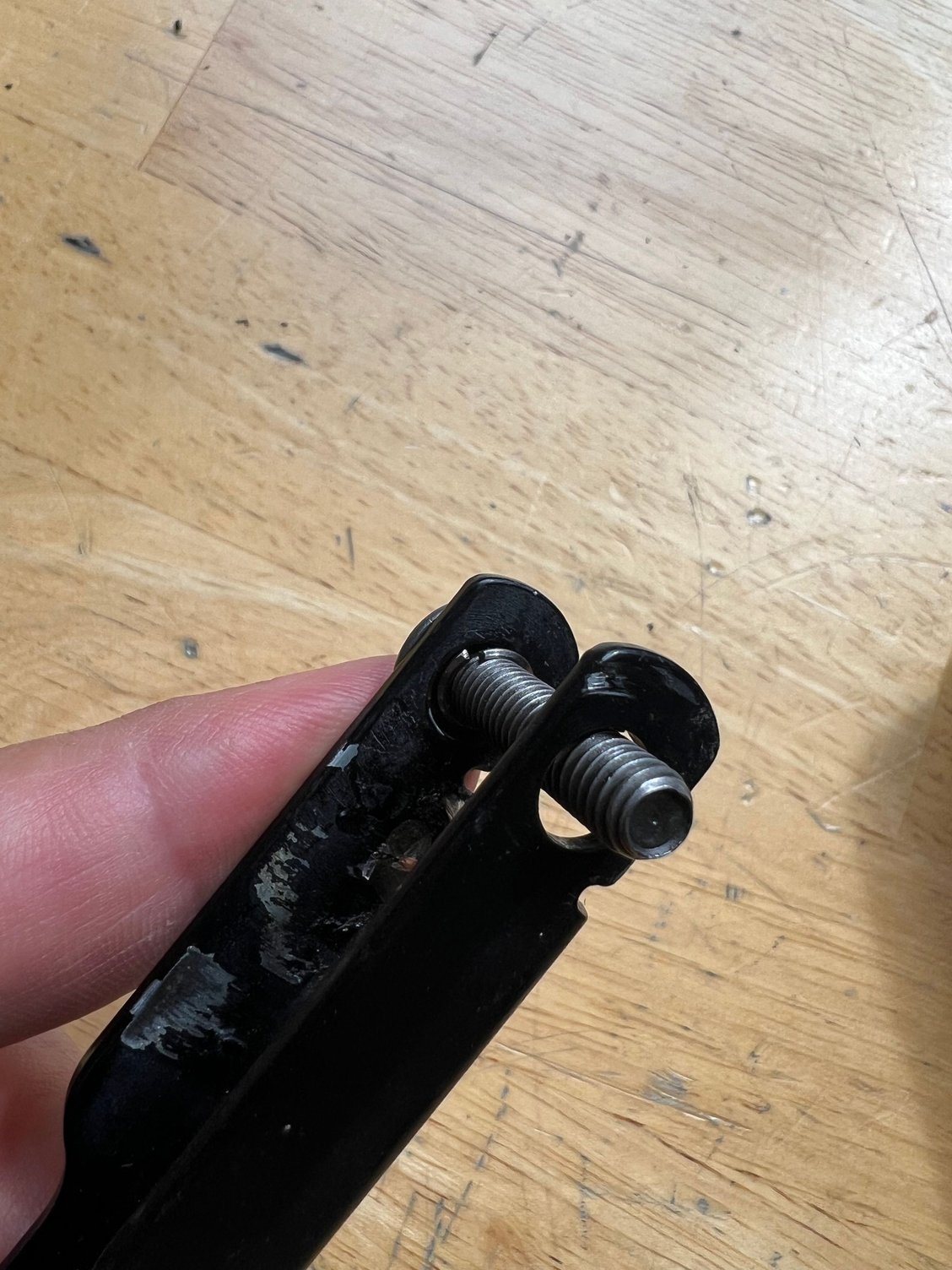

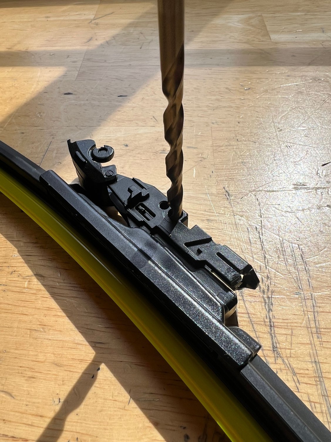

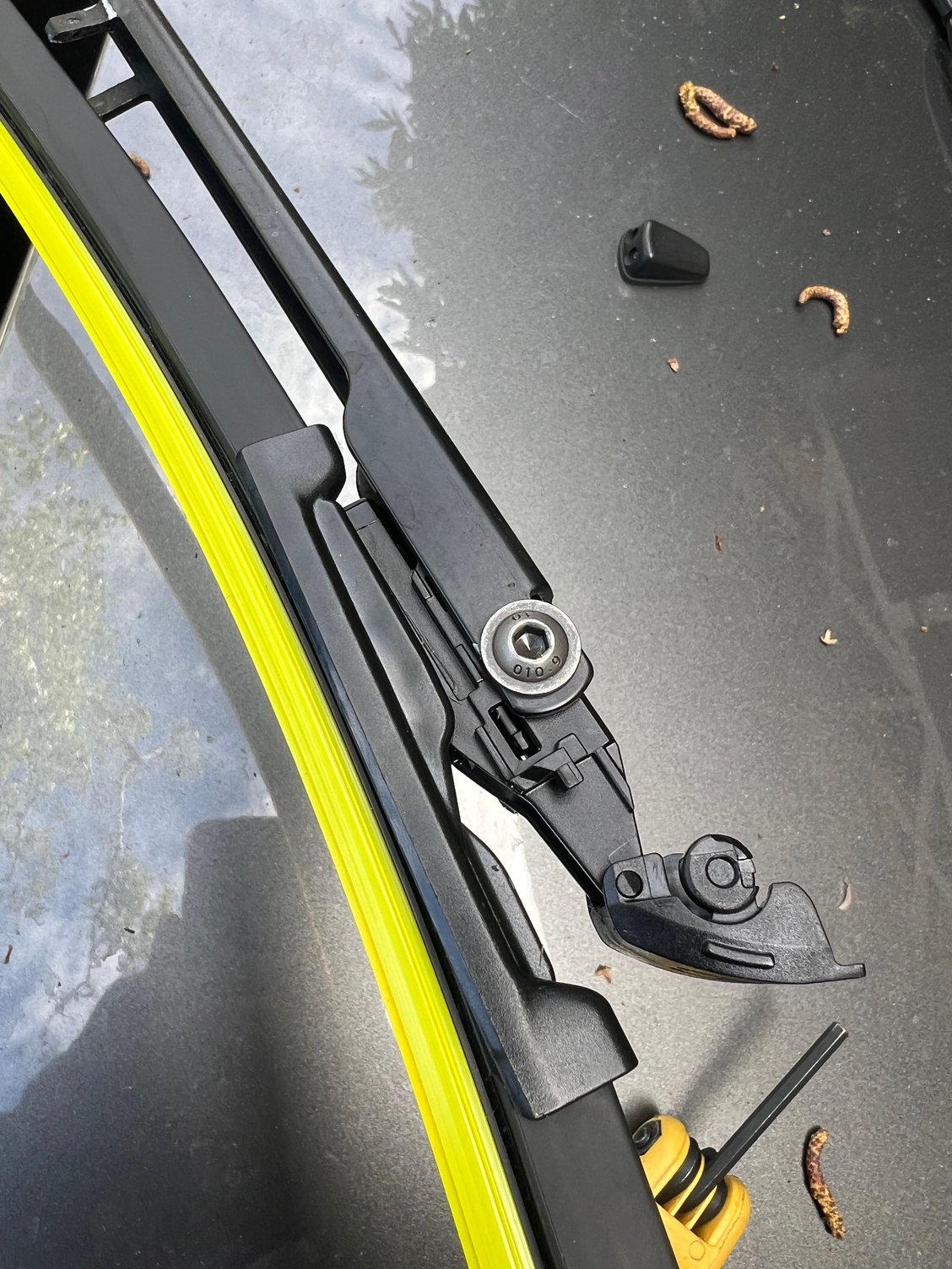

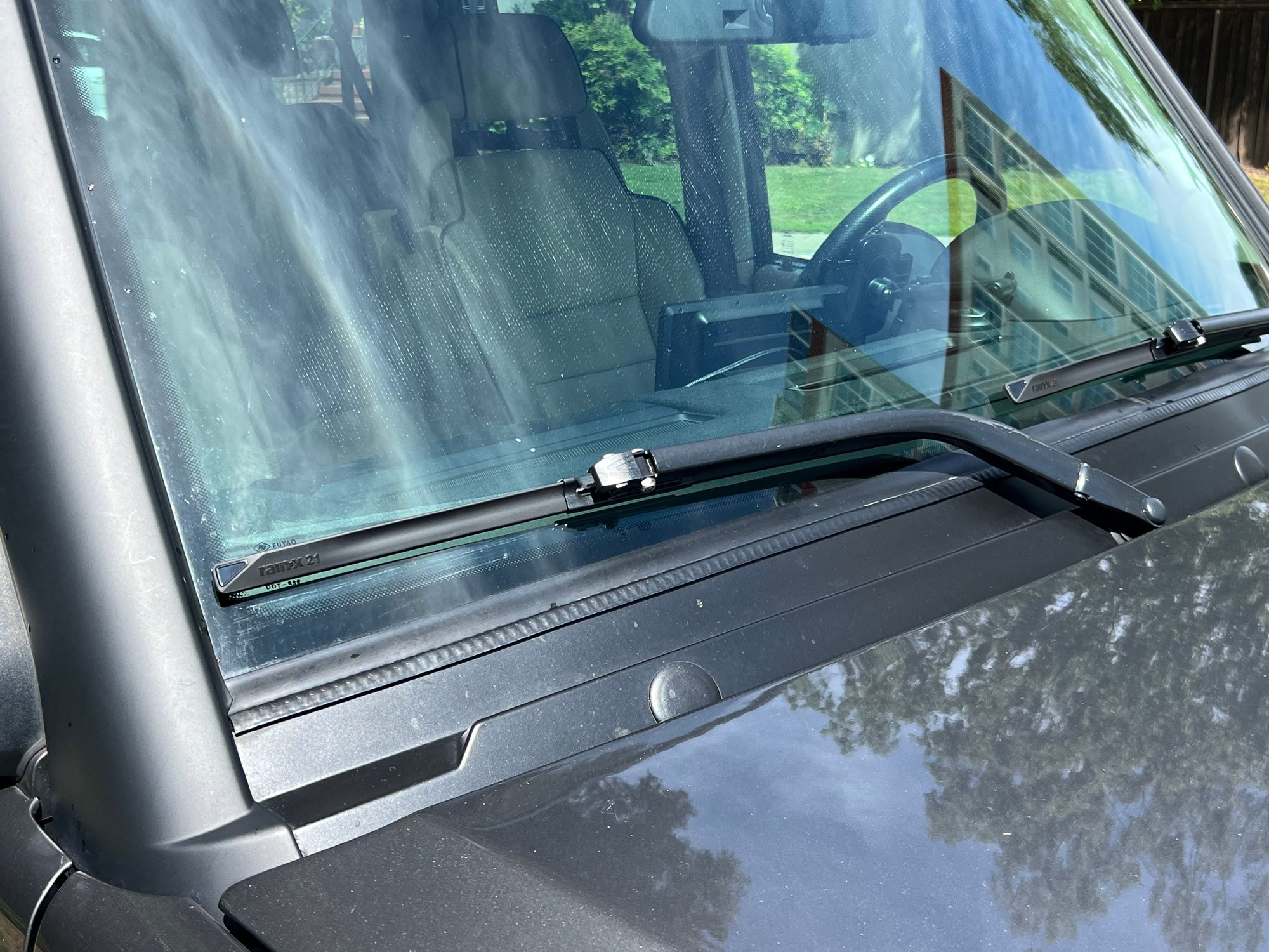

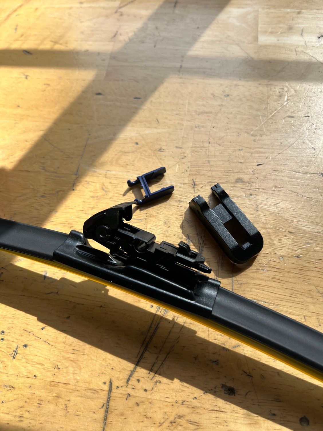

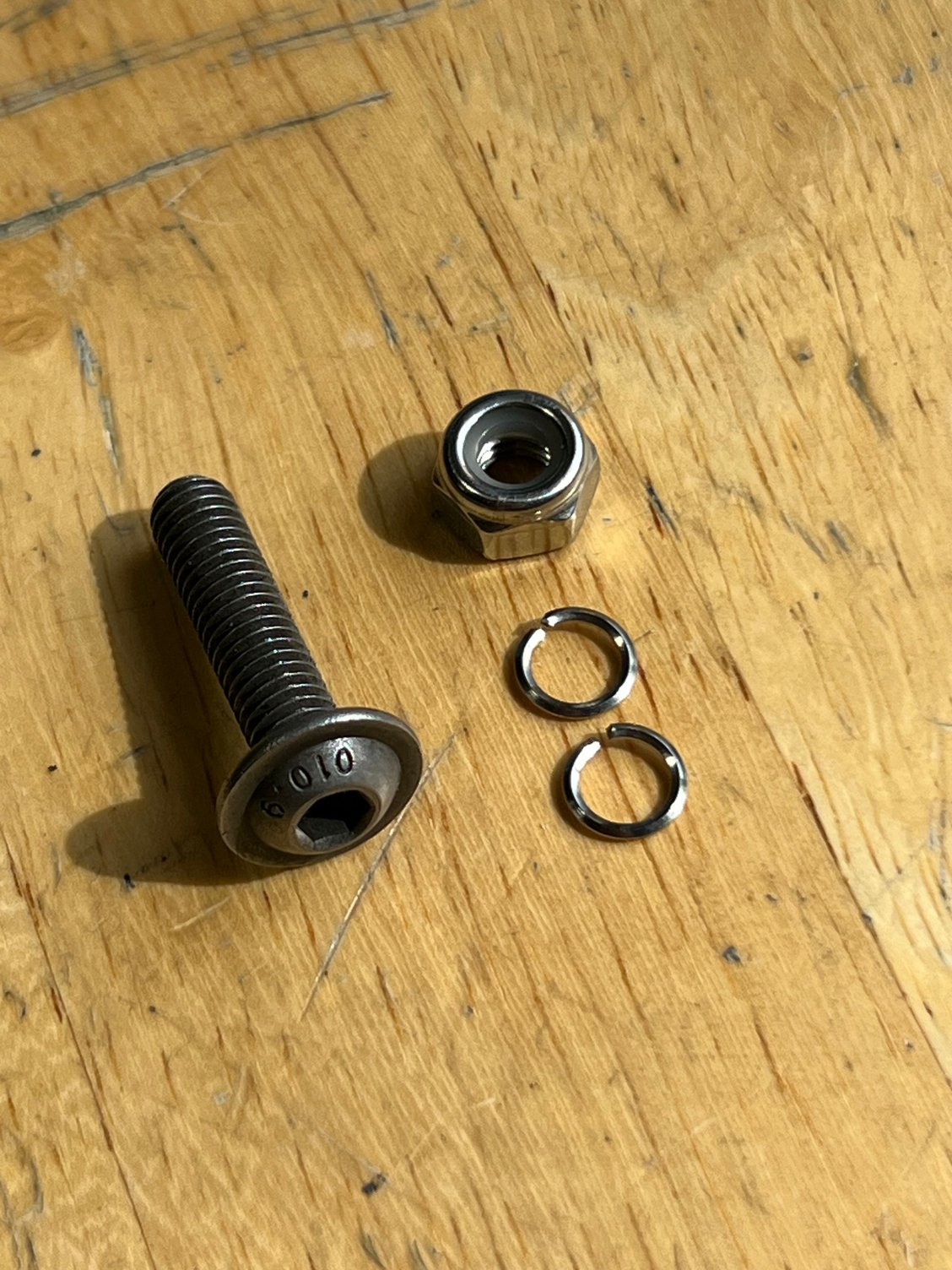

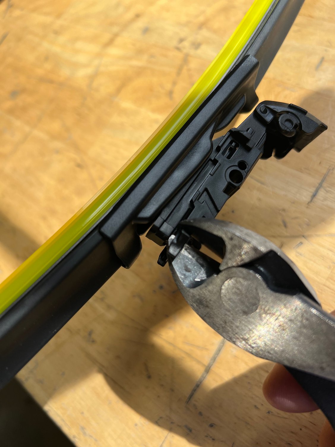

Driving up to Seattle from the SF Bay Area this weekend and needed new wipers. Figured I’d try something new.
Rain X Truck and SUV wiper blades. Fancy, expensive… They work well and look the part. We'll see how they do up north.
Not too much fiddling to get them on.
Got rid of all the attachment parts, had to cut some tabs off, and drill a hole out a little (.234" drill) to get an M6-1.00 X 25 bolt through the wiper. Used a stainless nylock nut. I also made some little washers out of an M6 Helicoil to try to make up for the difference between the hole in the wiper arm and the M6 bolt.
