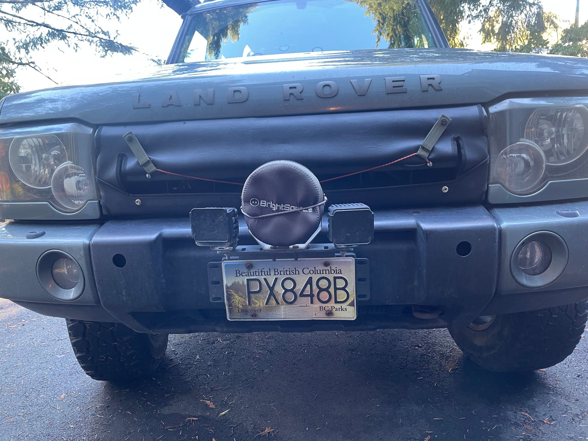

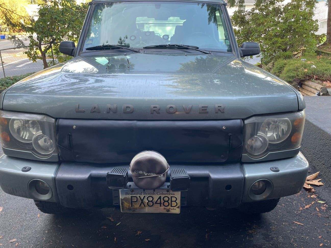

My solution is a radiator grill cover.
In minimal testing, 1-hour drive around town, a short highway run, and a long uphill to home. The outside temp was 41F, my maximum temp was 194 as rolled into my driveway after 20 minutes, 30mph uphill with several stops fully closed up.
The temperature range was 176ish to 181 while traveling once warm.
I have an 8-hour off-road trip with my local LR group this weekend, I will post the results from that trip. It has about 40 minutes of highway followed by 5 or so hours of off-road then hiway again, temps are expected to range from hi 30F down to 30 on the trip.
Fully closed is not ideal in many cases so I have the local shoe repair guy making up a couple of straps for a 50% close, which I believe will be the sweet spot most of the time. Open and closing takes about a minute, from getting out of the seat, closing or opening the cover and back in the seat.

Ok the update after an 8 hour drive on Saturday. I will keep this updated over winter as we get colder temps.
Ambient temps were between : 32 and 40 Degs F
Travel consisted of a 20 minute highway travel wait for the group then about 20 more highway and about 6 hours for trails with stops for lunch
40 minute highway to home
On the 1st run full closed up the disco warmed up to 177.8 and stayed there dropping to 174-175 when I came off the throttle and slowed down to the meet up point.
The 1st part of the trip was fully closed up for about 40 minutes highest temp was 188 after after a long stretch of low range steep hill climbing. Temp dropped back down quick - just load.
The remainder of the off road was done at 50% open highest temp again was 188 on the final hill climb out but pretty much 174 -177. Staying at 177 under load dropping as I engine braked on downhills in 1 gear low.
Lowest temp was 160 which was on a long downhill
While airing up with the hood up the Disco stayed at at a solid 174
The 40 minute drive home was fully closed up 177.8 solid other than coasting or braking then she dropped to 174. At the 1st full stop at a traffic light 181 and at the last light 183 just before I got home that is long uphill stretch at 30 mph with several stops. The trip home was about 34-35 F
Overall this was very successful
50% open - the green clips just tuck in the grill for 100% closed, the clip to the lower attachment points for 100% open.
