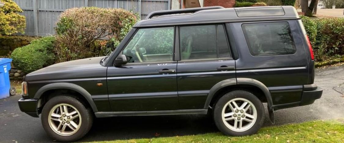

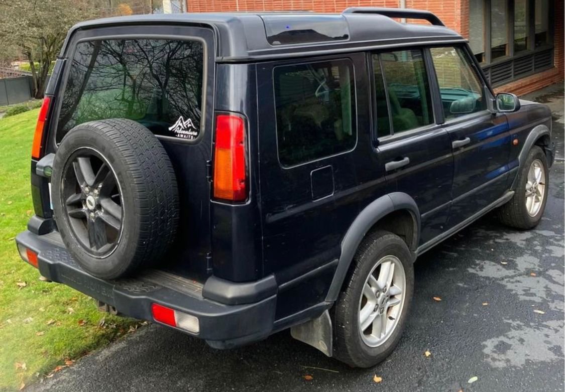

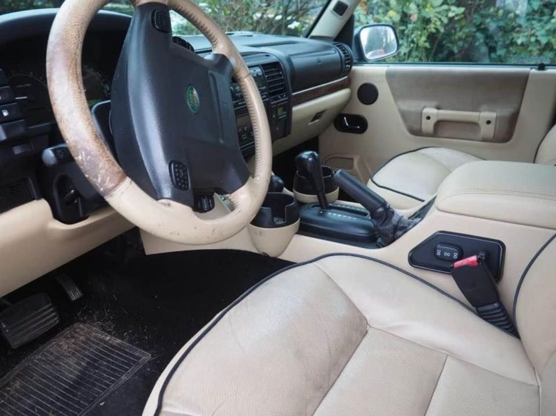

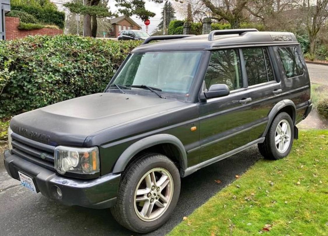

Thanks everyone again for your insights and suggestions. I did end up buying one from a local guy yesterday. 2004 disco 2 with 156k miles, engine looked good, new brakes and decent tires. Had catalytic converter replaced recently ( as the originals were stolen). All the interiors look ok, most of the functions work except the driver seat doesnt heat and fog lights are broken. No leaks and suspension feels good. It does throw a bunch of O2 sensor codes and ‘service engine soon’ so will have to take it to a shop to get everything checked out.
so far it drives great, comfy
