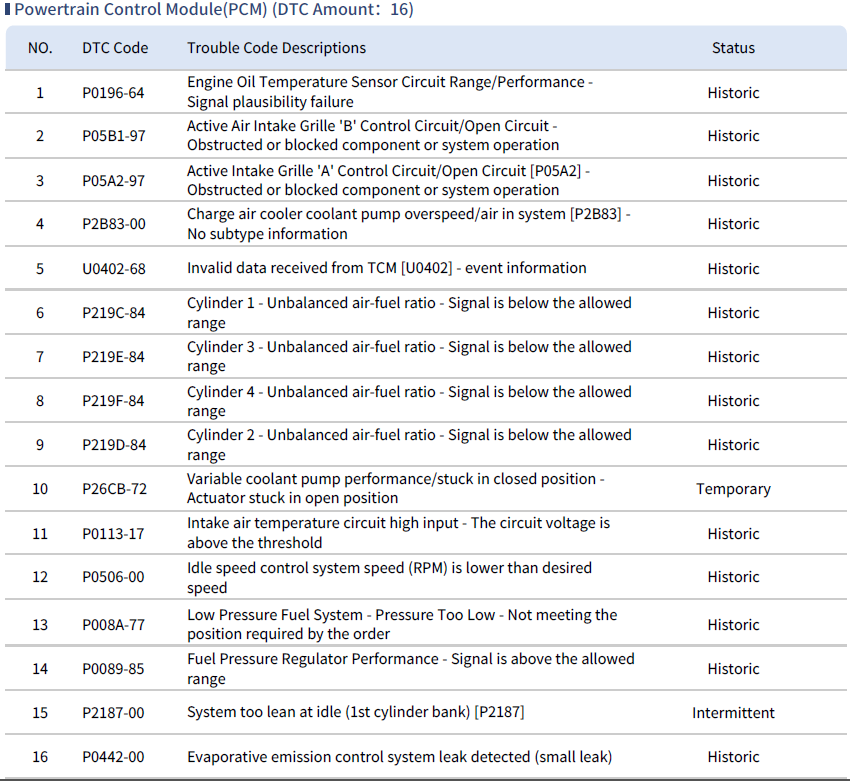

Does anyone know if the 2020 Disco has a typical PCV valve? If so, how accessible is it? I know this code can be tricky to pin down but I'd like to start there. I'll do a smoke test in a day or so.
