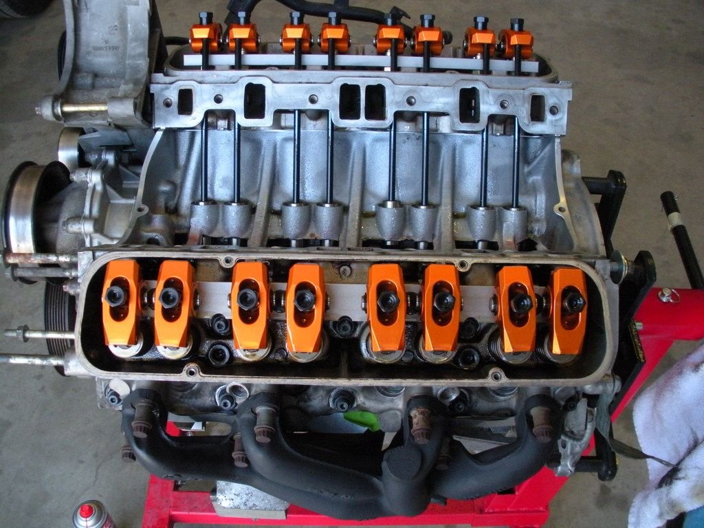

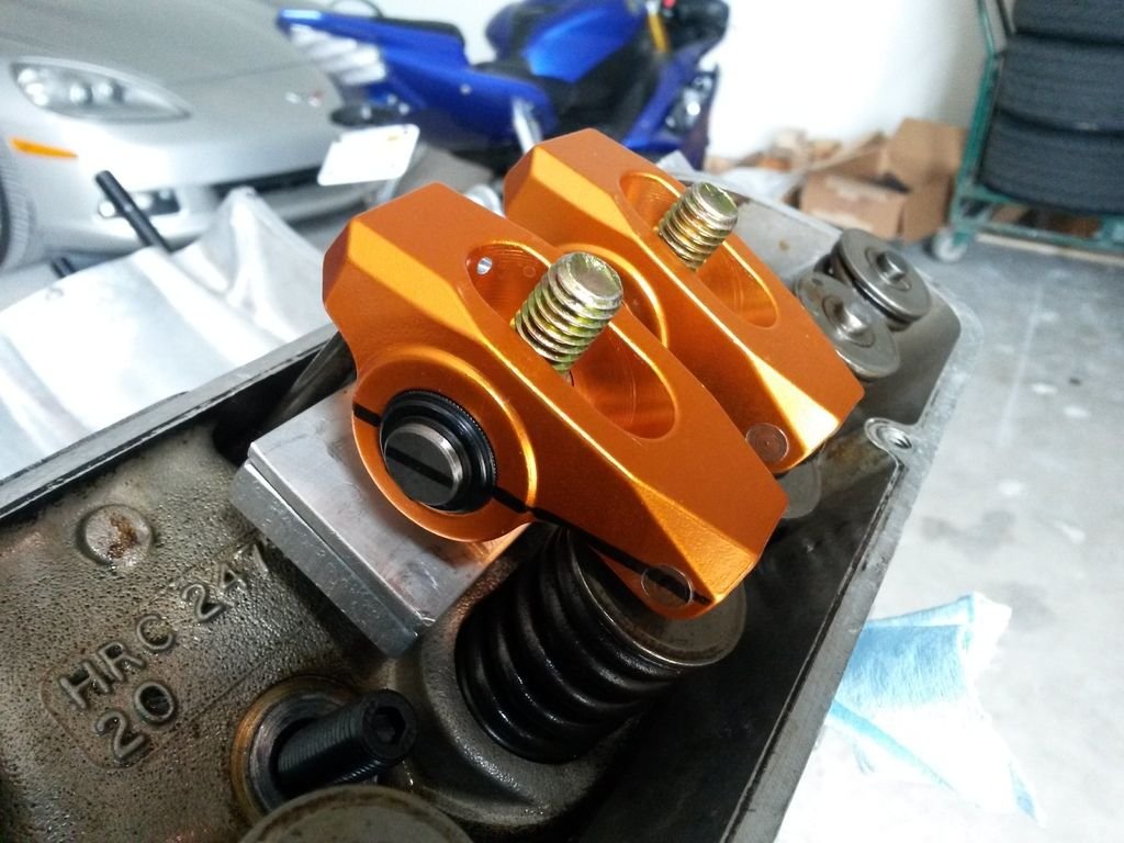

So, how many of you guys are tired of the stories about rocker arms fracturing or the steel buttons falling off and the valve stem mutilating the arm? Yeah, me too, and I wasn't ok with dropping the major coin on a YT setup (with shipping for shafts, cradles, and arms I couldn't find it for less than $1800USD) so I decided when I built my new motor that I wasn't dealing with any of that crap anymore, so I designed and did all the CAD work for a stud mount roller rocker conversion for my 4.6 in my discovery 2. Basically what gets replaced is the lifters (however it looks as though you could possibly use the stockers), pushrods, old rockers arms and shafts come out, new stud mount adapter plate mounted in place, then custom made offset self-centering roller rockers mount to that. Oiling path is rerouted to first feed the lifter then pushrod to roller rocker cup, bearing, and so on. No more bronze bushings, everything is nice roller and/or needle bearing now. The only hiccup is the baffles under the valve covers had to come out in order to accommodate the extra height inside, however I've had this setup running on my personal LR now for 10k miles and don't have any oil consumption issues. Anyways long story short I'm not interested in getting rich off this stuff but thought this might be something that my fellow 4.0/4.6 LR V8 guys might be interested in converting to and might help save some extra disco 2's from the scrap yard. I think grand total for everything to swap the valvetrain over I ended up in the $1200-1300ish range, but I felt the peace of mind in never worrying about the stock setup failing me was worth it.
Thanks!
Mike
Doing some original mockup prior to the CAD work.
Finished and preload set, ready to get the valve covers back on.
