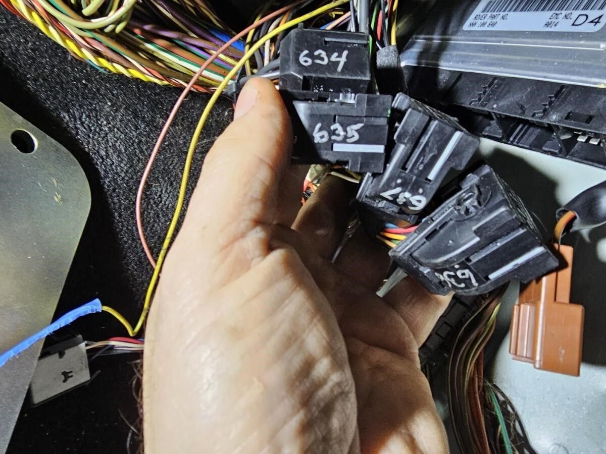

Finishing up my build and wanted to post some wiring pictures which I could not find much info on searching here. I know not many people are still working with this kit but here you go.
These are the main ECU harness connectors in the AC Manuel labeled with the connector number.
Hope this helps anyone like myself who pushed off wiring to the end.
