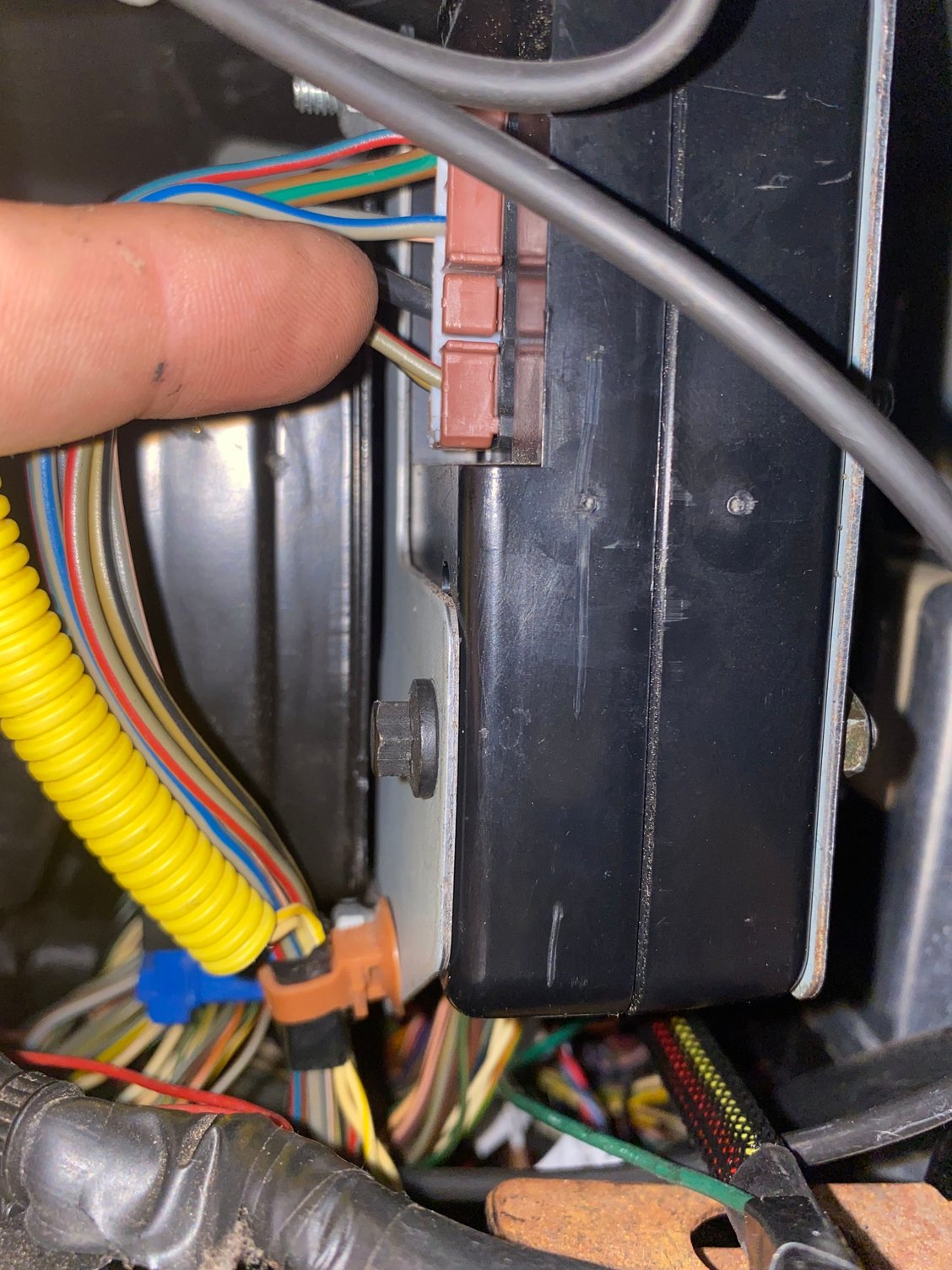

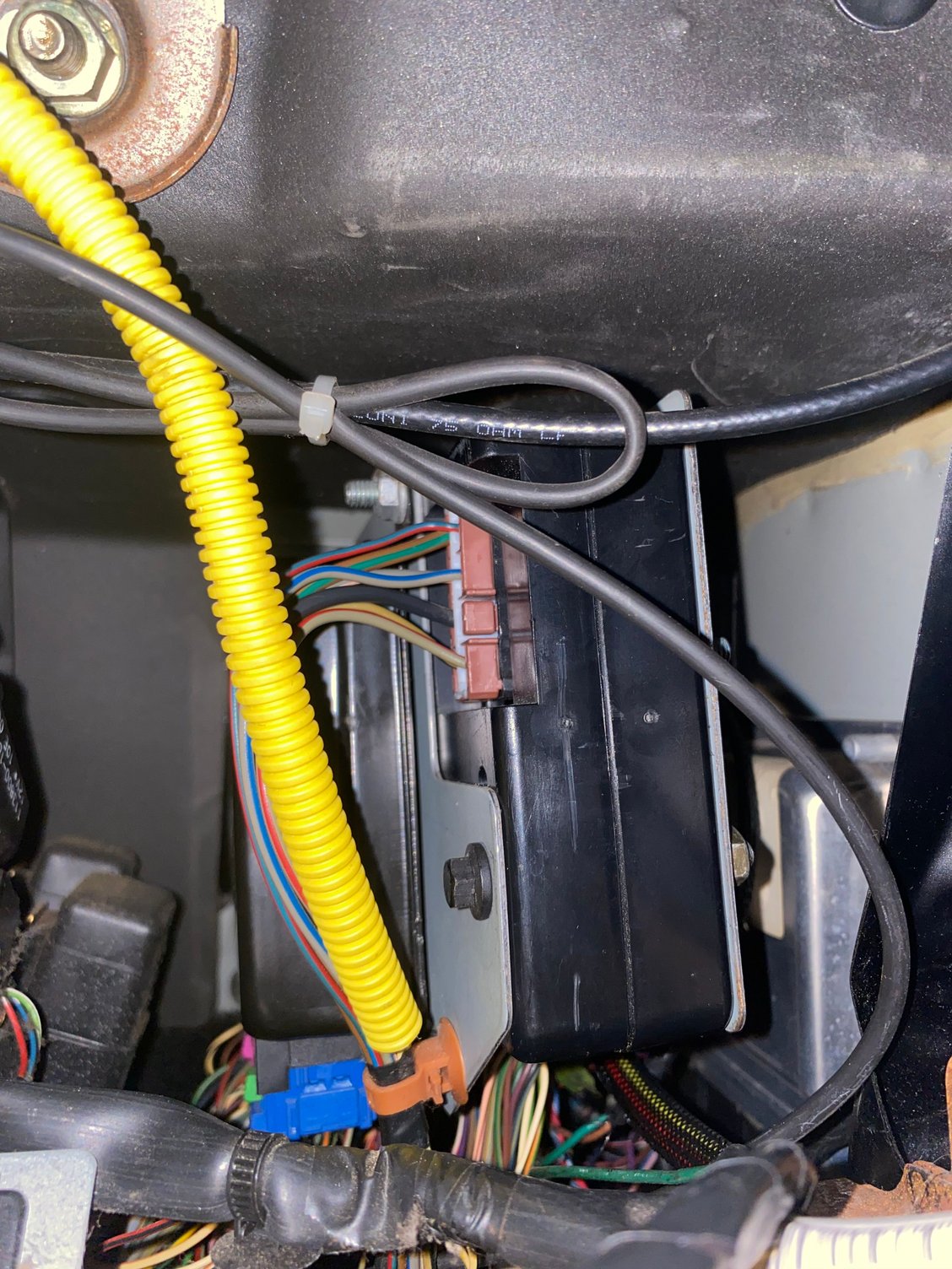

Mike or anyone else who might know. I have lost my switched/cranking power to the engine fuse panel. I have checked over all of my work, confirmed continuity, etc. and now believe that the ecm is preventing the main relay coil from grounding allowing power path to the fuse block. Picture below from another post of where I lost my power which I had until I wired up my LS satellite fuse/relay panel which should not have anything to do with it. Any help is greatly appreciated. Also have the M and S lights on the dash flashing and unable to communicate with the Rover ECM
Found the issue. I didn’t have the brown BCM connector pushed all the way in.
