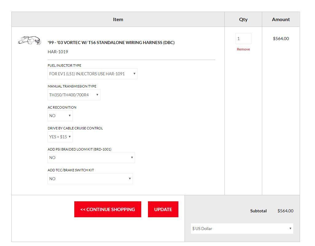

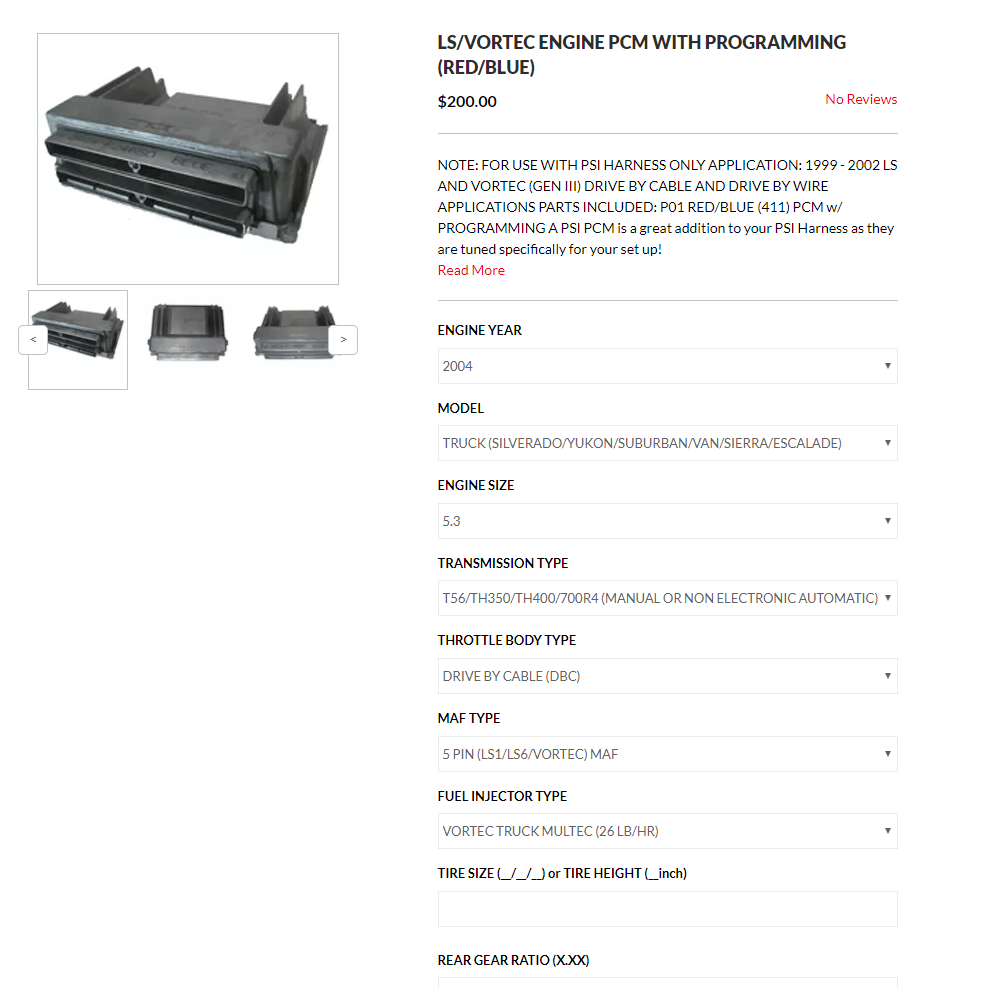

QUESTIONS:
-I see the recommended PSI wiring harness but there's quite a few details on drop down menus before ordering and I don't know which exactly to use....... so I STILL haven't ordered.
-I know I can use a $35 dollar ECU from a RED/BLUE silverado 1500 but I'll need to have it sent out and programmed? Where is the file to give to someone to program it?
A. If I use the $200 dollar PSI brand recommended ECU instead of a junk yard, will it be programmed already or will I have to spend the same money to program it somewhere anyway? I notice there's some options in the drop down menu and again don't know exactly which to choose, I figure if I was to choose the right one it'd be programmed already then? Or is there something further that must be custom?

As you can see above, there's a few options on both the ECU and HARNESS to choose from...... anyone able to confirm EXACTLY what we need?

As far as the ECU goes, you can get a junkyard one but there are a couple of things you need to make sure it has. Mainly the DBC. See LT1swap.com for identifying a DBC ECU.
As far as I know there is no file. If you get a junkyard ecu, you just need to send it to someone with HP tuners to get the VATS disables and send them the specs from the ACE manual enabled during the programming.
For the wiring harness you need DBC and select T56 transmission. Select the correct maf and injector plugs and you're good to go. I feel the ECU from PSI is too expensive and you can do it much cheaper but it is a one stop shop.
