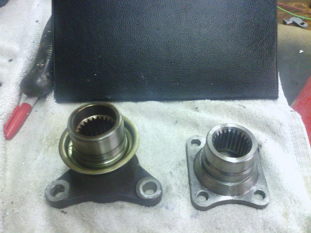

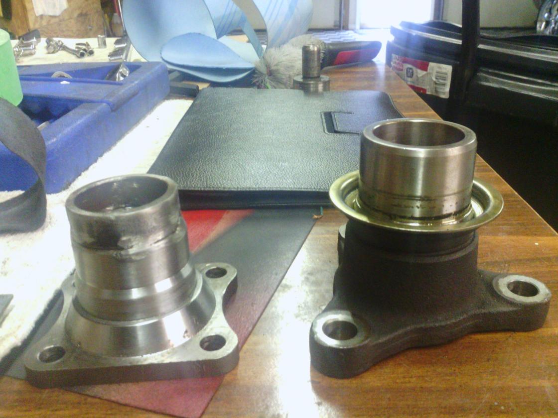

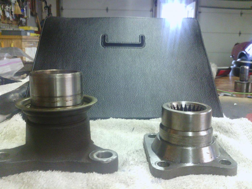

A few pictures attached.
Notice the difference in the stock yoke and the Rotoflex eliminator yoke.
I had to add on to the length of the yoke to get any preload at all, it was at least 1/2" short. Maybe they sent me the wrong one, or maybe others have had this same problem?
I installed the yoke without realizing it was incorrect, and it came loose and trashed the seal, made a heck of a racket too.

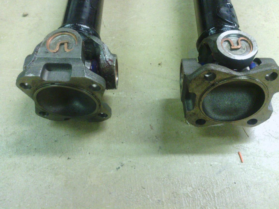

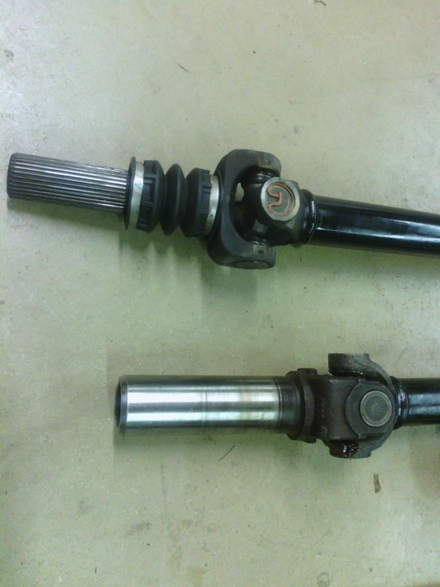

Default More Pictures...
Sorry for lack of pictures lately, I know a build thread without pictures is USELESS!!!

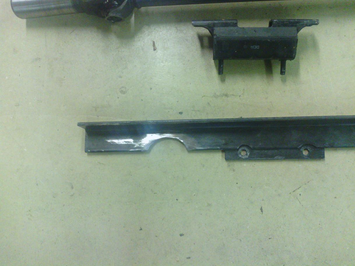

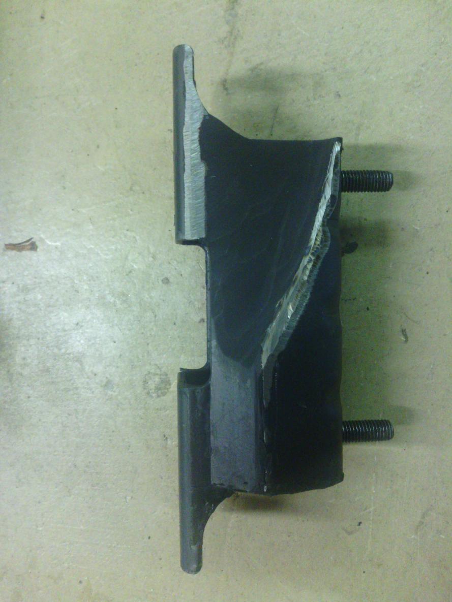

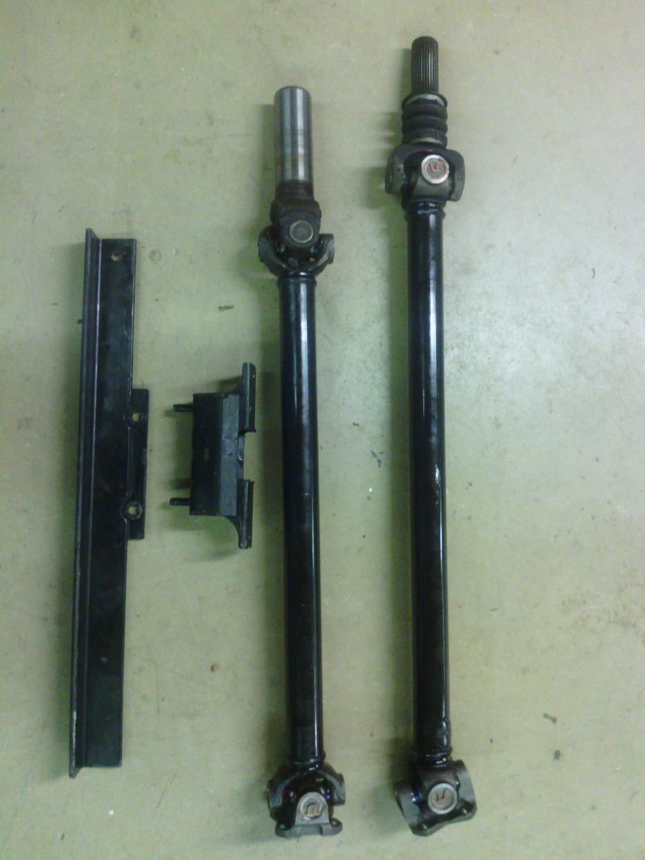

Here are some drive shaft and transmission mount mods.
Attached Thumbnails Here We Go Again, My LSX Swap Thread-img_20140315_072307.jpg   Here We Go Again, My LSX Swap Thread-img_20140315_072320.jpg   Here We Go Again, My LSX Swap Thread-img_20140315_072339.jpg   Here We Go Again, My LSX Swap Thread-img_20140315_093200.jpg   Here We Go Again, My LSX Swap Thread-img_20140315_101300.jpg

Notice the half moon notch in the cross member shown above. This was necessary to clear the front drive shaft. Also, the cut away in the transmission mount was needed to clear the exhaust. Probably will have to completely rework the exhaust at some point. The original design and install was for the first TC I used which ended in failure. The second TC is way different and clocked in a better position, so now everything is in the way of each other. I temporarily installed some flex exhaust tube to get the truck going quickly.

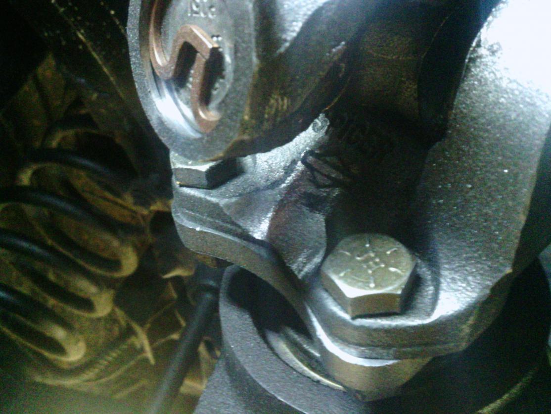

Shown below is also a picture of the rear high angle u-joint which as it turns out was not high angle enough. I had to clearance it some to keep it out of a bind.
Attached Thumbnails Here We Go Again, My LSX Swap Thread-img_20140315_182027.jpg
