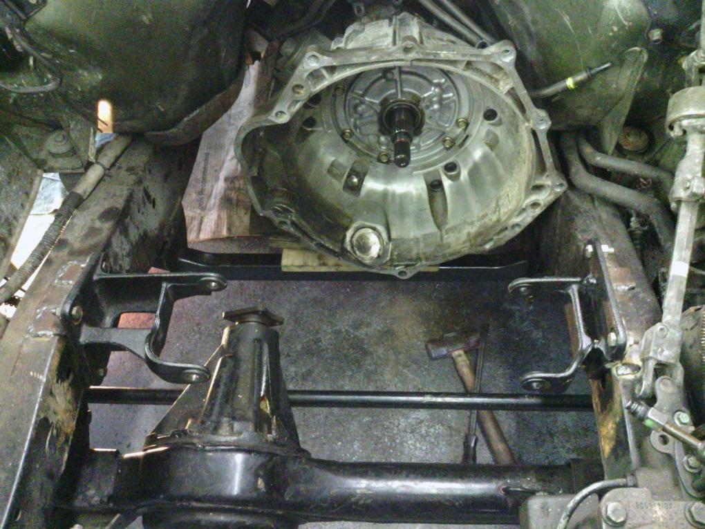

I made a lot progress this weekend, some issues solved, some new problems pop up.
1. Got the engine mounted, I modified some F-Body mounts, swapped the left and right, shortened one and lengthened the other and flipped both upside down.
2. Made a first and second attempt at the transmission mount, looks like I might go with a solid mount, but I need to locate the transfer case in place to check for interference.
3. Test fit the AC compressor , water pump, mechanical fan, alternator and my Power steering pump relocation bracket. Also the intake and exhaust manifolds.
My modified Power steering pump bracket and stock truck compressor seem fine, no problems.
Intake is very tall (may hit the hood). The alternator is even taller. Also, the intake is hitting the AC lines on the firewall, I whacked them with a 2x4 and got about 1/2", I will need to shave another 1/2" off the back of the plastic intake.
The mechanical fan needs about 1 more inch of space before it will work. This is using the Rover fan instead of the GM (GM is about 2 inches thicker), the radiator will have to be moved forward some or convert to electric fans.
Right side truck exhaust manifold will work with no modification, but the left side will require something other than the truck unit, (it kicks out right into the frame rail). I did not get the center outlet LS3 Corvette manifolds I mentioned in an earlier post. I have an F-Body manifold I think may work with some extensive surgery.
I have decided to try to make the GM NP2 transfer case work. **** Key word is try.**** It is a driver side front output so I will have to clock it 180 degrees. Because of limited case material available to drill into for mounting studs, I cannot angle it down far enough to suit me. So it looks like the floor pan just above the right side frame rail will have to be clearanced some. Vent will also have to be relocated. And now for the bad news, the GM case is a center output for the rear shaft, and it is sticking out a lot farther to the rear than the Rover case. It looks like I will have to build some sort of transmission/driveshaft tunnel in the rear seat floor area.

Here is picture of motor mounts installed not painted.
