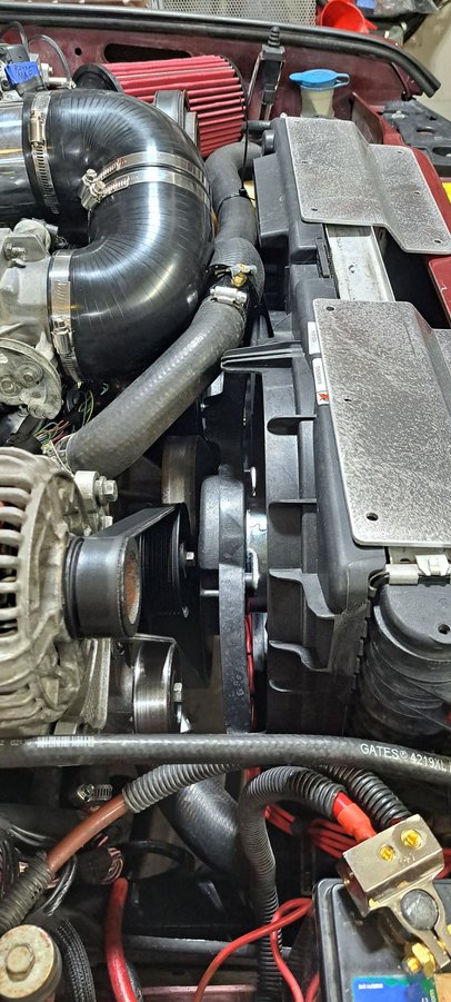

I am running an LM7 with the factory radiator, Ford fusion electric fans, a rando 12" condenser fan, and almost pure water in the cooling system (I planned to have leaks/ make changes). Mine only got really hot when I was sitting waiting for in n out for m
y pregnant wife for 25 minutes. I don't know how hot that was, but the gauge was showing where it was when I probed another time and got 230. This was before the condenser fan was installed and I'm not certain both fusion fans were even on because I reused the breakers from a previous vehicle and didn't get out to check.
Since adding the condenser fan (stock one was frozen), installing new breakers for the fans, I've consistently seen the temp gauge sit in the middle and from multiple probings this has shown me from 200-210. My fans running the gm pcm and run independently of each other and the condenser fan. I might get one fusion fan to run with the AC later though.
Picture of my half completed fan mount.
You should be able to tune out the mph cutout of the fans. I assuming your engine is considered a gen4? Gen 3 stuff can be changed easily with pcmhammer and tunerpro if you can find an xdf file to translate it all.
