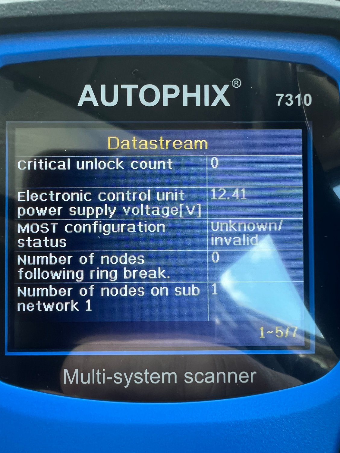

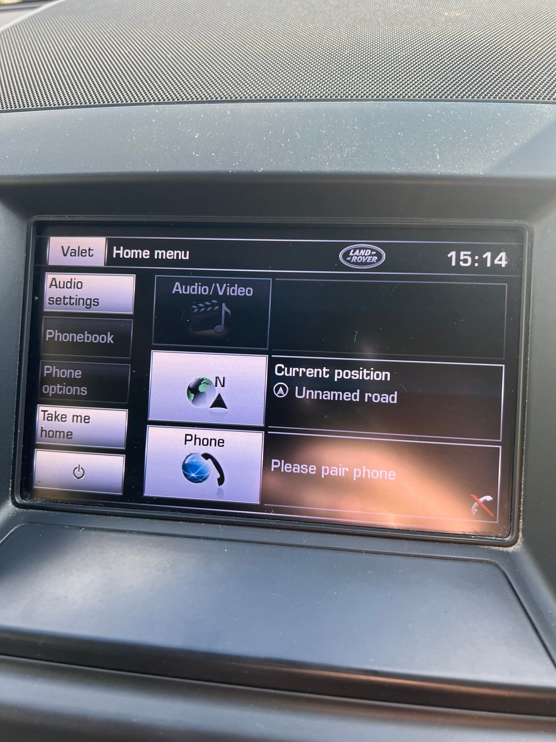

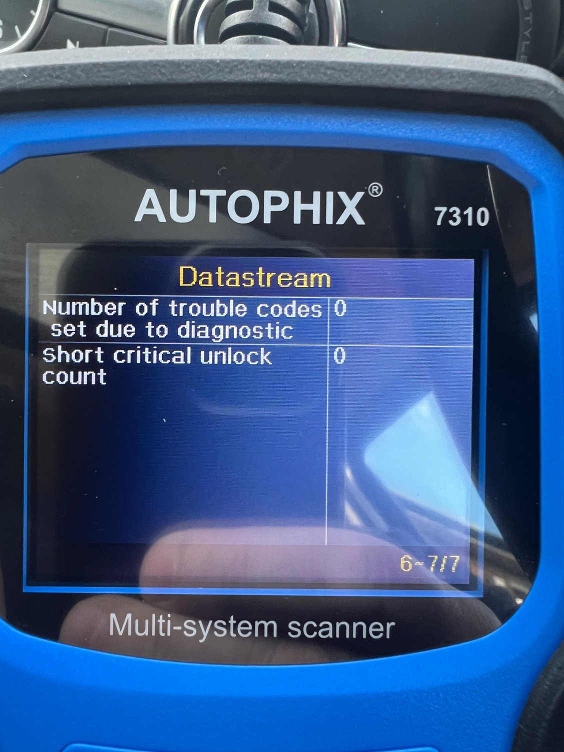

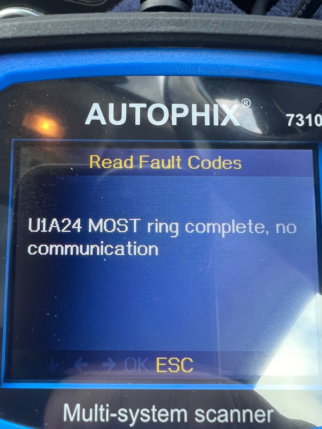

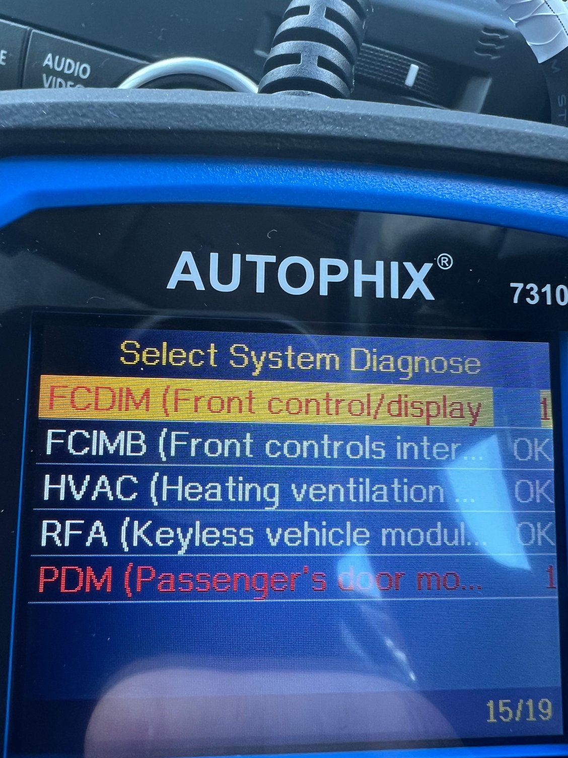

Good Afternoon need advice!! I have a Freelander 2 2013 SDA I changed my battery a few weeks ago no problems just had to reset the windows to open and shut automatically. The vehicle as been stood for a few weeks and now the radio isn’t working the sat nav says Navigation is initialising
Please wait……………………. And my phone will not connect to the Bluetooth.!! And finally the cd player will not let you put a cd in or out. You can set the time and date ect….. look at the balance treble bass other than that nothing. i have had the battery back of and pulled the moist bridge in the boot and left for a hour reconnected it all but still no difference. I checked the fuses in the boot they look ok there is a module in the top left hand corner I don’t know how you can check that and a red square at the side of that don’t know how to check that I have had a code reader on the car and re registered the battery. I came across this error just wondering if any body has any ideas on what it is or how to repair the problem. I have attached some picture to help explain the problem. Thank you in advance and any advice would be greatly appreciate.
