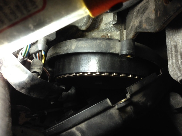

Thanks for the feedback. I'm looking for a tool set and then will replace the belt in the pictures to start. I took it down the road and everything seem to go good for the few miles I drove it. I didn't want to blow the belt and wreck the engine. Would you suggest that I change all of the belt or just start with the one making the noise?

Marty, you could get by with just the rear belts for quite a while as the front will stay in tension as the video suggests. The condition of the front belt can be checked by pulling off a cover, and then examined for cracks on the back side. If it doesn't have too many cracks, and the edges are not cupping up, then the front is probably good for a while. You can get by with just the rear tool if you can find it. It's the one that resembles a dumbell. The front belt is a good days work if you've never done one before, so plan accordingly.
Overall it sound like the engine is in good shape. With that compression, and if it isn't using coolant, you should get a lot of miles out of it. Absolute most important thing with a KV6 is to not let it over heat. Check the hoses routinely, always watch the gauge.

The front belt has a few cracks in it from what I can see. The covers won't come off without removing more parts so I just took a quick look. I took this picture.
Marty
04 Freelander 80K

You can find the belts on EBay, with the best buy to get all three as a set. The bolts are harder to find, although I always get mine from Atlantic British. Just search their site for Freelander Cam Bolts. The front belt looks OK from the back side, but your mileage is in the replacement zone for belts. Exercise care with no high revs or fast acceleration and you should be good for a few thousand more miles.
