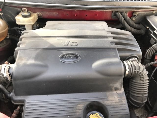

I've had my 2000 Freelander V6 for about 10 years now and it's always been reliable and a strong workhorse. It's now at the stage where the windows no longer work including the tailgate window but that's not a real issue for me but instead of getting rid of the old chap, I want to turn this into a play thing and wonder what the maximum tyre size that I can put on my 17 inch wheels (current size 225/55/R17)

I'm thinking of keeping it simple so no bodywork mods for now so only a 20mm lift kit for now( simply because i've got loads of other jobs such as brake drums/shoes/cylinders and the power steering ram feed pipe too which will be a pain I'm sure) A little welding on the jacking points but not much else really so i suppose whilst I am doing all that, a bigger lift kit could be on the cards but not sure if I actually need much more.
The V6 has been pretty bulletproof and has just over 100,000 miles on it now so it sounds as though I've been lucky. It goes really well and comparable with my previous 3.0V6 S Type Jag which is why i love it so much.
