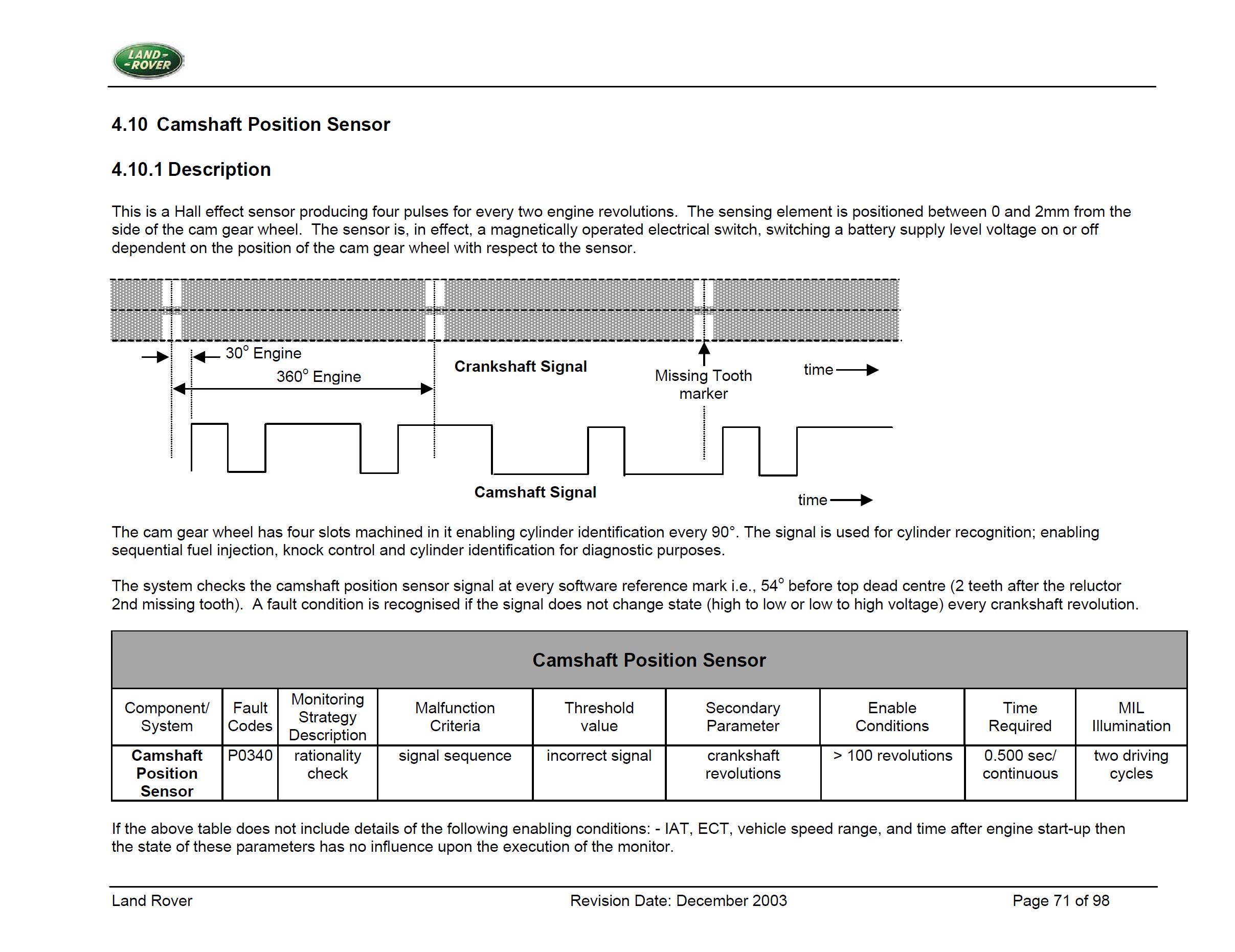

have you touched or verified the timing gears on this engine? I believe its off or installed one tooth off.
