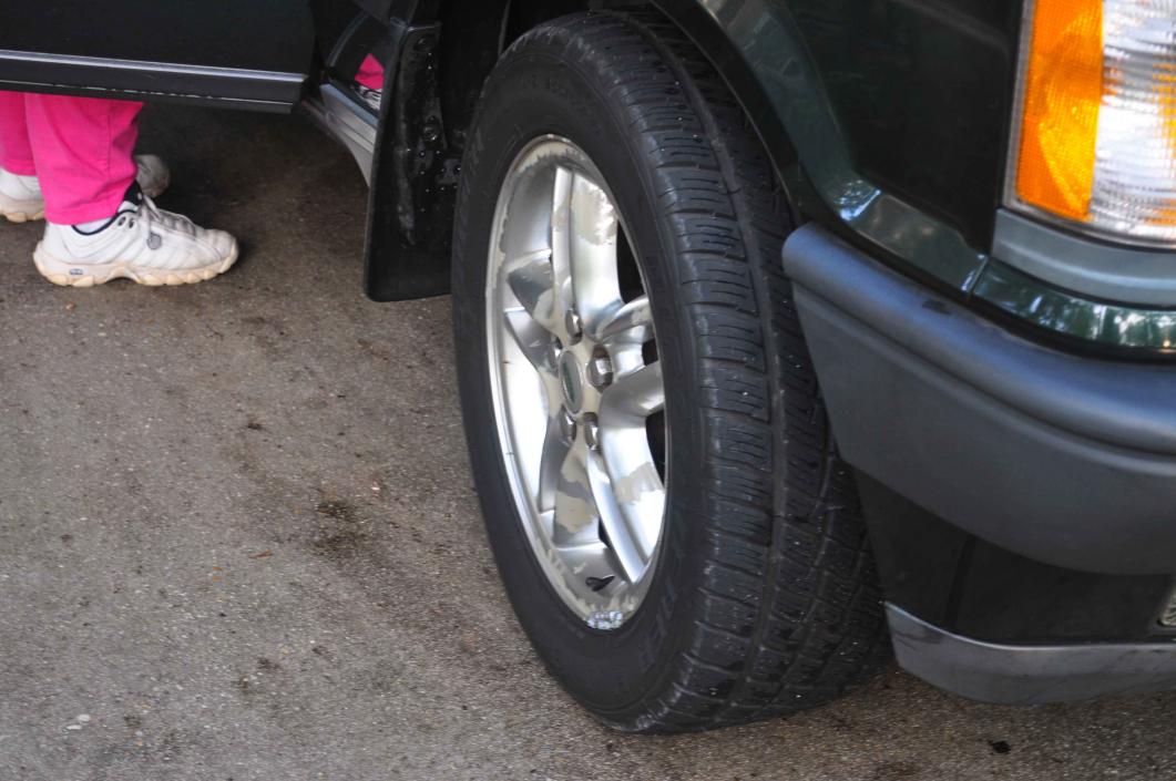

Anybody have an idea about the wheels as to refinish? Looks like Chrome Paint

It can be painted, looks like a bright aluminum finish. The best thing you can do is have them powder coated. They will last much longer.

I would avoid any type of "chrome" spray paint. You will not be satisfied with the results. The spray cans just don't have the capability to look like chrome to much satisfaction.
Stick with a metallic color and you should be fine. I would go with a dedicated wheel paint (Duplicolor makes them in many colors, I've used that product and it works great) as an alternative to powder coating if you don't want to go through unmouting the tires etc.
If you decide to DIY post up, I've done many sets and can offer some tips.

You might check out www.wheeltechnologies.com. They used to be a customer of mine and they do a great job on restoring factory wheels.

You should consider doing a wheel exchange instead of chumping up the money for brand new wheels. If the wheels on your Rover are in otherwise fairly good shape, you can pay like $500-$700 + a deposit and a wheel exchange company will ship you a set of wheels they've refinished (chrome plated or powder coated) that look brand new, then you ship them back your wheels and when they get your wheels, you get your deposit back. It works about to be about $125-$150/wheel or so. I've done this before with success and am getting ready to do it again for another car of mine. There is a company here in LA called LA Wheel and Tire (www.lawheel.com) that can do this and it's more cost effective than buying brand new wheels. There are some rules on the condition your wheels must be in to do the exchange though, i.e. no cracks or major rash, they need to be straight, etc.

Headliner is sagging in the back and also over the visor area, and for $350.00 they do it all new so no big deal.
It is at the vets getting a WHOLE bunch of things brought up to perfect so the last will be the wheels and headliner.
Like the idea of the exchange but I think we will walnut blast and refinish as soon as the racing season is over. Modified is needing some TLC for the last couple of shows. WE wrapped up the points championship so now it is just fun running.
