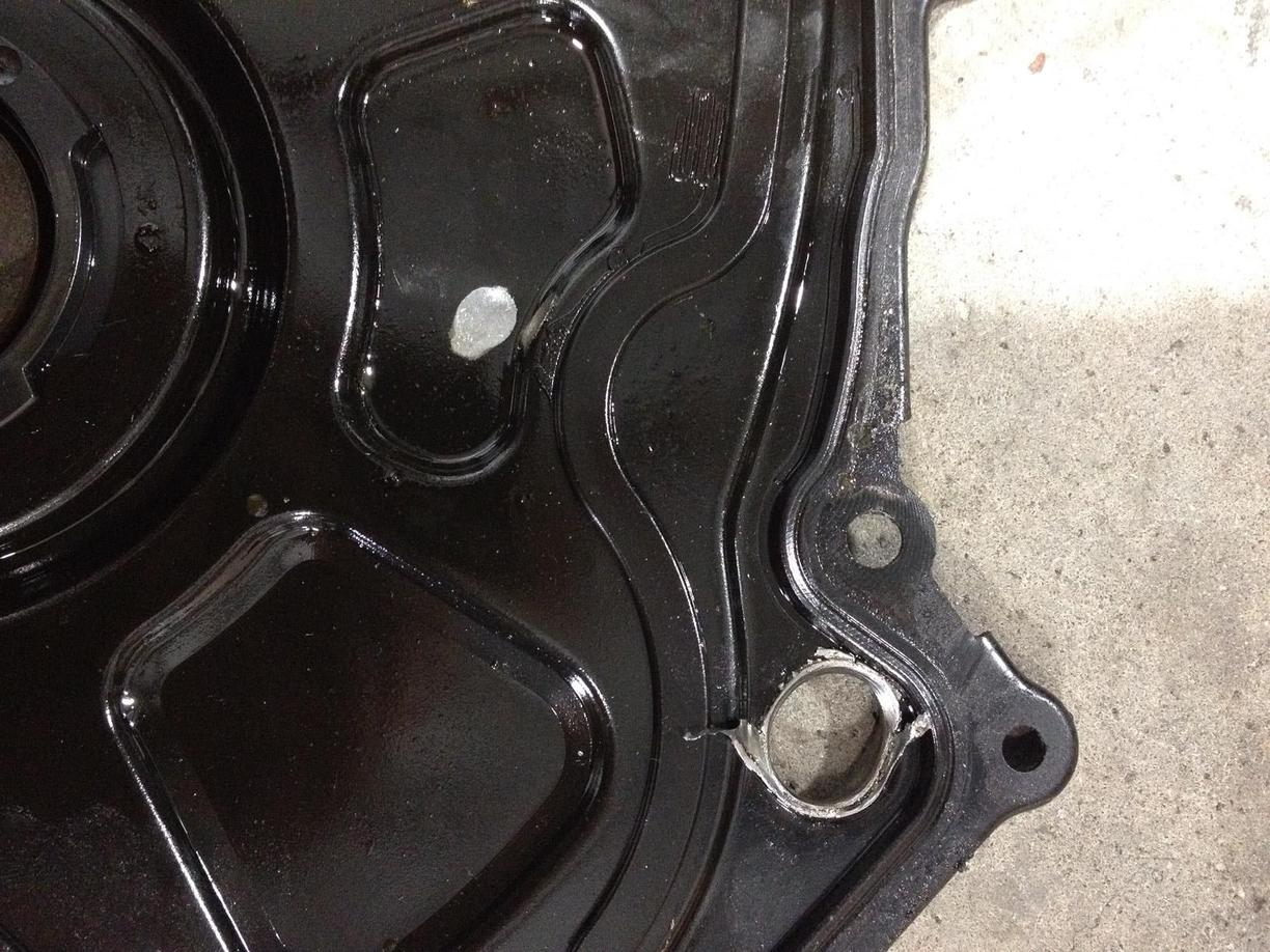

2010 isn't a 4.0, but the all new 5.0 V8, hence all these problems. Timing chains on these aren't a "wait and see" situation. They should be done when they get noisy. The rattling that is heard (I have not heard yours) is the chain slapping on the guides. Once the chain gets enough slack, it will make contact with the oil jet at the crank gear and damage it, further compounding the problem. The worst one we did, slapped so hard and for so long, it actually broke two of the bolts for the passenger side guide. The customer continued to drive until one of those broken bolts wore a hole in the front timing cover. By that time it had jumped time and was towed in. These problems won't hit a "plateau" where you can just ride it out, nor will it get better.

Notice on the front cover, that the one bolt wore a hole through the cover and the second broken bolt was starting to (shiny spot on cover).
Passenger side chain guide: two broken bolts
Broken guide bolt wore hole in front cover.
