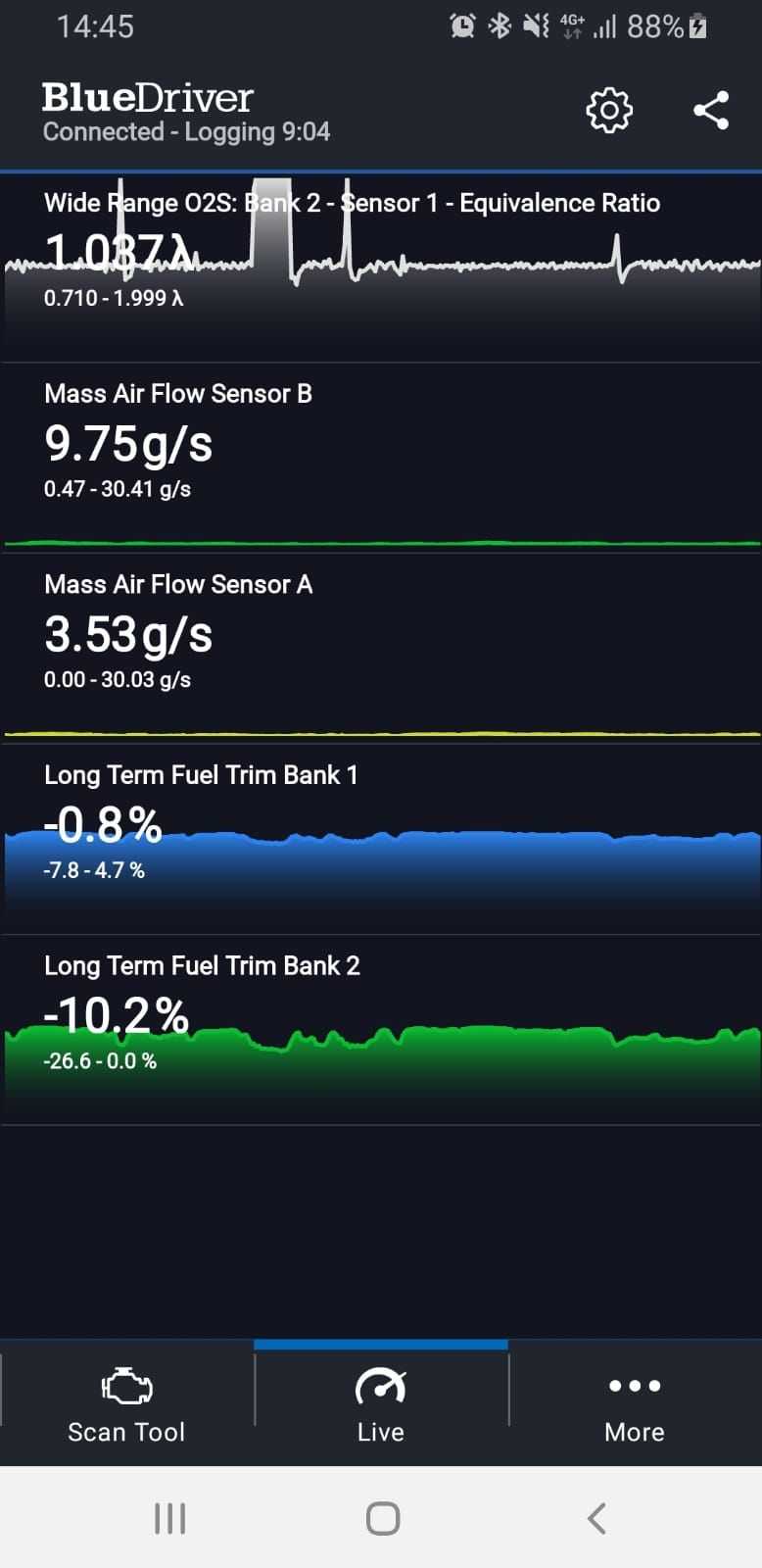

I have a scanner and am seeing the Long Term fuel trim is always 10% lower in bank 2. Even while at speed. No codes from the O2 sensors though.
The last thing that did recently was replace the oil fill camp with O-ring. The idle is a little more constant, and the long term fuel trim is about 7% lower in bank 2, but never goes above %-1.0. Never rich.
