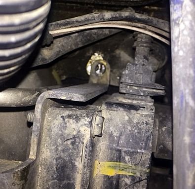

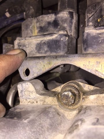

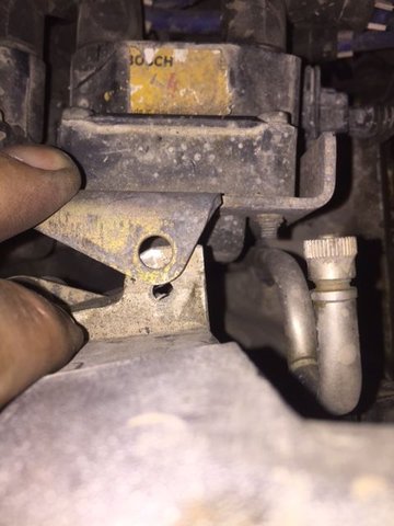

Got pictures of both the side/bottom holes on the coil pack mounting bracket. They are also not attached, but in their case I do not see anything they would attach to.
I did track down that the bolt size for the top of the coil pack mounting bracket is M6 x 12. I'll get a couple of those and use a bit of leverage to see if I can get the coil packs to mount, and hopefully to ground.

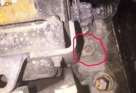

Aren't there bolt holes a little to the left of where each of those lower bracket holes is currently sitting?

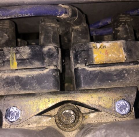

Default Bolts in. Found the missing holes.
