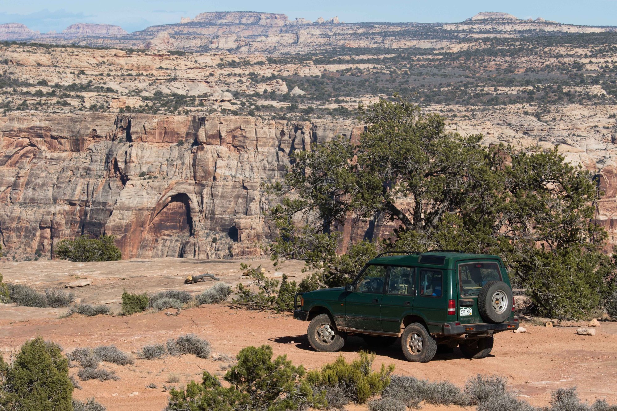

Hi all, just joined this forum for some advice. I'm driving a 1995 Discovery 1, my dad bought it a couple months before I was born and I grew up in the car. Wasn't interested in it for a while but then he taught me how to drive it a few years ago (manual trans) and I've loved it since, it's taken me a lot of great places in Colorado and Utah and Oregon. My dad has upgraded it slightly over the years, maybe 2-3 inch lift, ARB bumper, lights, replaced front right panel and hood after hitting a tree about 15 yr ago. Over the past few years it's also gotten pretty tired, it's around 225k right now. It's currently my only car - It's still driving alright on paved roads and I can get it 17-22mpg driving conservatively (drove strong from CO - WA in May) but I've been warned not to put it in diff lock or low or drive too rough of roads with it, which is a limiter. I've had two mechanics look at it without tearing into it too far plus what else I know about it and these are all of the known issues/needed fixes:
