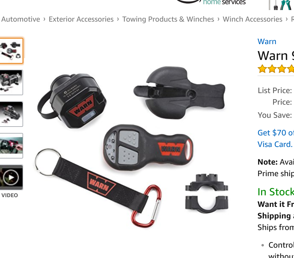

So I recently picked up a awesome used Vr10000s Warn winch for the LR3. I need a new winch controller. Has anyone tried out this set up?
http://a.co/dAatFHI
Description
With easy plug-and-play installation, the Warn wireless winch remote can control your winch from anywhere within a 50 feet range of your vehicle without the need for hard-wiring or splicing. The truck version fits all Warn truck and SUV self-recovery winches with a 5-wire control pack or contactor. Equipped with a shock-resistant transmitter, durable key fob for convenient storage, and is sealed for protection against the elements.
So is it worth the bang for the buck or should I just stick with the tried and true wired controller?
Attached Thumbnails Thoughts on Warn winch contoller-screenshot-2018-02-28-21.37.38.png

Hard wire it.
Safer.

I had the warn wireless setup & it worked well. Just grab a spare set of batteries as they used to be a weird size. Other than that zero issues and it was a well built wireless kit.

Call me superstitious but prefer hard lines, know for sure when something is supposed to work vs not. I just do not see utility in the new wireless stuff, more points of failure, how to guarantee winch wont run when sorting out a tangled drum during use for example.
subjective view of course.

I never had any delay issues or problems with the Warn Wireless setup. It was much more handy using it vs a wired controller. I'm a steel cable guy vs synthetic line and being able to walk 25+ ft away while winching sure beats being only 10ft away (if that..) from the cable.
The batteries last a pretty good while and the system will go to sleep. I like the safety feature of how you have to hold the buttons down for 5sec or so & then it will be enabled vs oh I just tapped the in/out button and it came on causing damage or hurting someone. The mount is sturdy, the remote is sturdy, and just have a spare set of batteries for out on the trail and call it good.
Old Mar 3, 2018 | 09:00 AM
Pretty much made up my mind on getting the wirelessly set up. Seems like it's worth it
