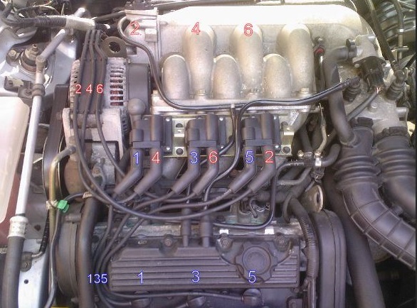

Got myself a Freelander V6 with a KV6 engine, non-start issue when warm.
I know what it is as have plugged in my scanner, my question is which bank is bank 1 on the KV6 engine.
Dont really want to take manifold off if its the front bank near the radiator.
Thanks
Mike

From my understanding Bank A or 1 will always be the bank with cylinder No 1 in the firing order. So facing the engine bay No 1 would be the front bank left hand side the Hope this helps

[/IMG]
Old Dec 4, 2014 | 05:05 PM
Rob C's Avatar
Joined: Dec 2014
Posts: 14
From: Poland
