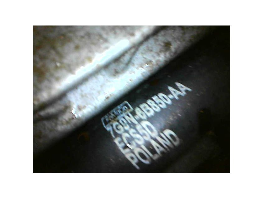

I didn't post all the photos and video I took with the borescope, but here's another one. It's a Volvo part number for a cooling hose, with "FoMoCo" and "Poland" markings which makes sense since Ford owned Volvo and LR during that period. I don't know how Poland compares with China for quality, but my gut says go with Poland if those are the only choices.

I brought my photos into an independent Volvo shop today. They said the hose damage appears to be from rodents. I had a rodent issue a few years ago, so maybe it took that long for a leak to develop.
I knew rodents like electrical wire insulation, but I didn't know that gnaw on hoses. They told me they've seen it before.
