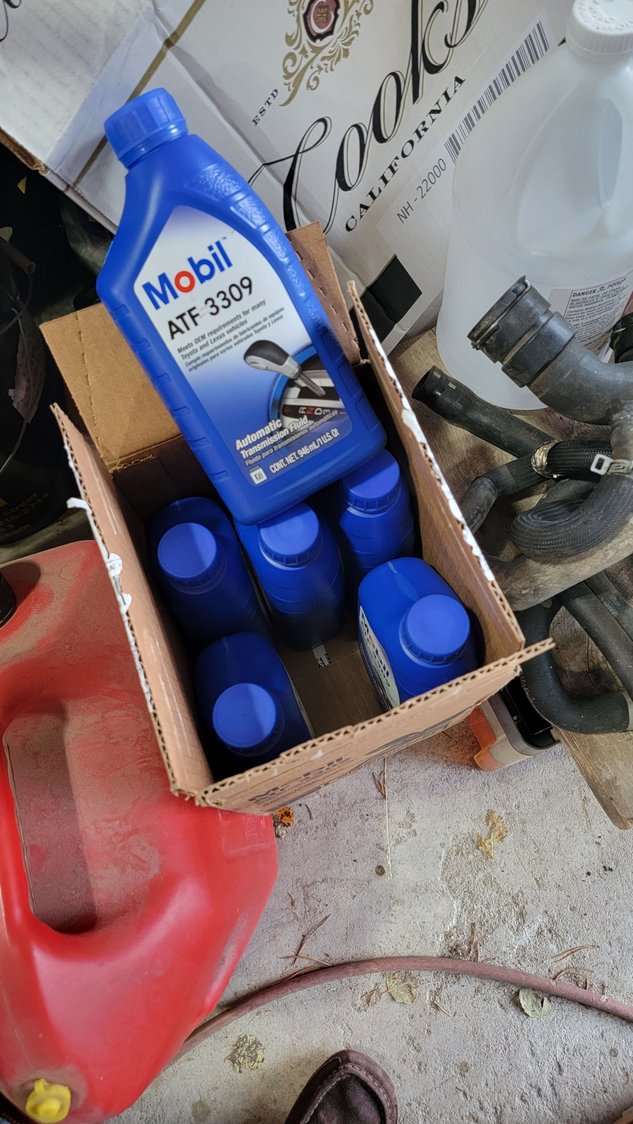

Sorry, I can't actually comment on the difficulty as I actually ended up finding that the rear main seal wasn't the actual source of my leak as I initially thought it was. I ended up doing a VERY thorough degreasing and pressure washing of the engine/transmission and found that the o-ring on the transmission drain plug had become hard and brittle and was no longer sealing. I took the opportunity to flush the transmission fluid several times and refill. I used about 16 quarts of Mobil ATF3309 for several flush/fill with a final fill on the 4th fill. The process is well documented on this forum. I finished up that flush/fill process with a new o-ring. Happily, there have been no further leaks, and the transmission shifts beautifully!!
The initial draining of the transmission fluid was so incredibly black but after three flushes the transmission fluid was red again. For me, the whole process took about a half a day as I did a quick test drive between each flush to ensure proper mixing of new fluid with old before draining.
