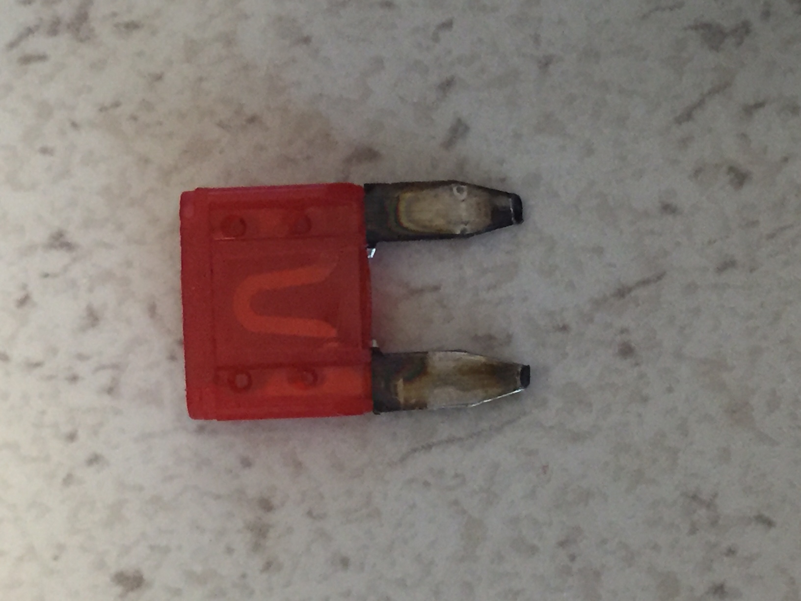

Default Relays and fuses replaced
Kevin,
I replaced the three relays shown in the picture (highlighted with a red square)
Top left relay is R1 - starter motor relay
Next to R1 is R2 - this relay provides the power for several circuits in the passenger compartment fuse box
On the right is R7 - this relay provides power for several fuses in the passenger compartment.
Also I attached a picture of one of my fuse's to show the corrosion
I am very curious to know what works for you.
Thanks
Paul
Attached Thumbnails 2008 LR2 Multiple Misfire - Please Help-relays.jpg   2008 LR2 Multiple Misfire - Please Help-fuse.jpg
