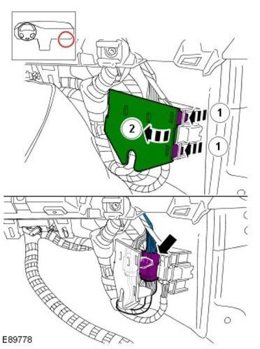

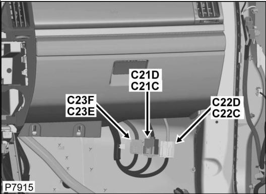

A shot in the dark since this maybe instrument cluster related. In the passenger footwell there is a module with three major junctions. I would carefully pull back the carpeting and make sure that the three connectors are seated and secure.
