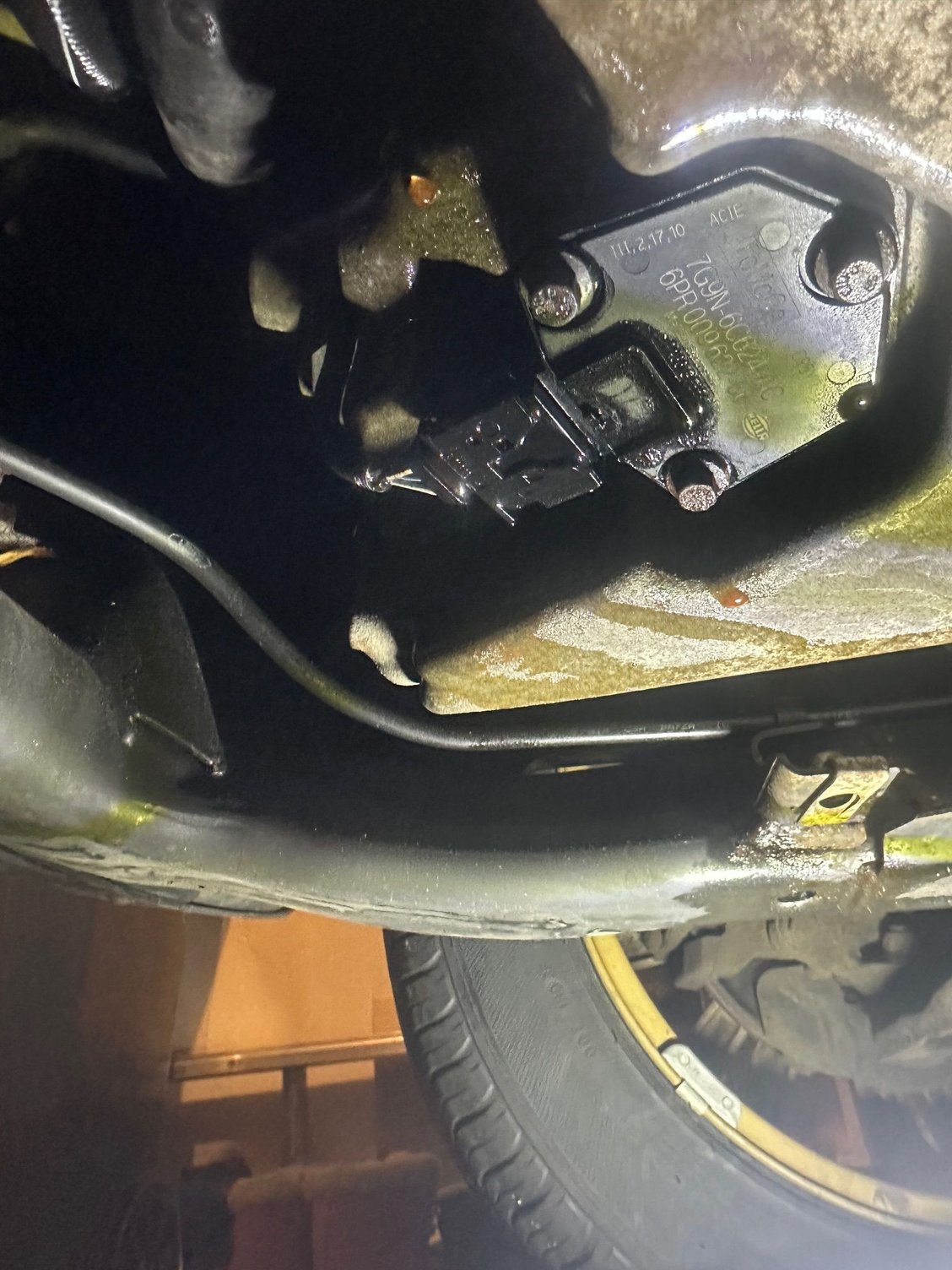

Hard to see in the picture, but it's still wet from the coolant leaking.  That's the front right tire.

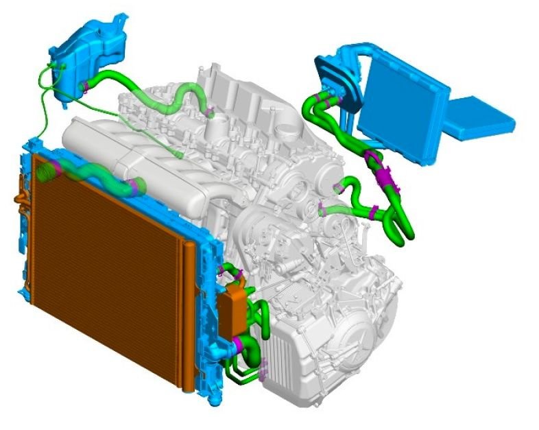

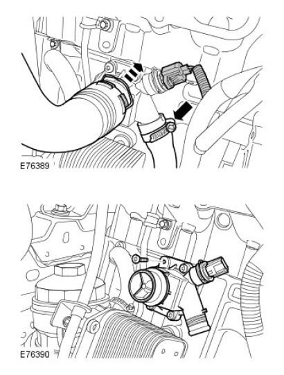

Lots of little coolant hoses and connectors all over on this thing. I replaced all of ours, including the radiator, last year. Based on the location of the leak on yours, which seems to be on the front passengers side area of the engine, I agree with the others here that it's potentially the coolant overflow bottle or one of the hoses connected to it. Or, since the thermostat housing is plastic, that could've given way as well.
Here is a diagram of the system - at least the parts not hidden by the radiator, along with a drawing of the thermostat and where it mounts to the engine block.

Thank you for the diagram. I'll give it another look when I get home tonight. I left cardboard under the car and the leak is almost dead center, rear side of the engine.
