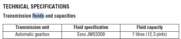

Anyone can recommend a good ATF for my 2012?
Aisin T-4, Mobil 3309, Toyota T-4, Valvoline MaxLife, Volvo OEM ATF, Idemitsu

I've used Aisin T-IV in my 2008, since Aisin is the OEM for the transmission.
Also the spec changed from 3309 to 3324 somewhere around 2012, not sure exactly which MY.

Aisin 3309 from Rockauto, can't go wrong!

I've been running Valvoline MaxLife in mine for the last 50K or so. I initially started using it hoping that clean fluid would help resolve a shifting problem I was having, but I ended up replacing the valve body in the transmission, which fixed it. Filled it again with fresh MaxLife after that and all has been well with over 250K on the clock now.
