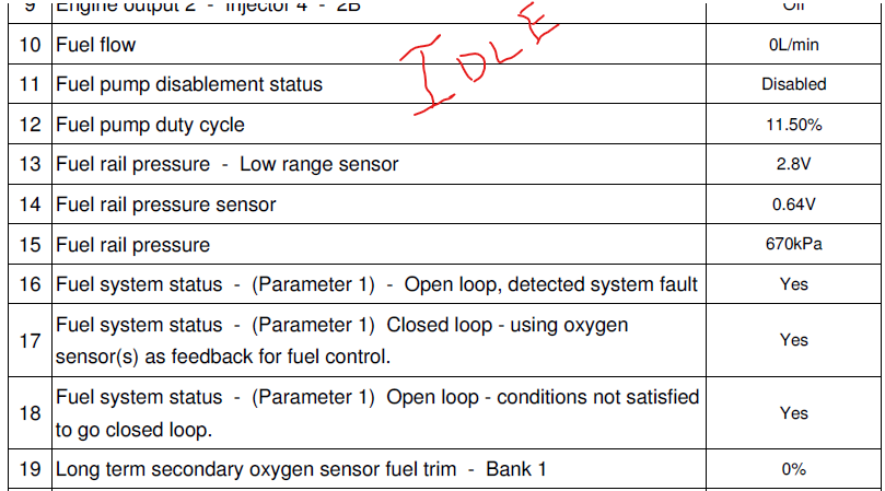

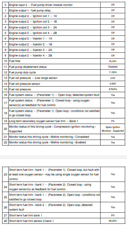

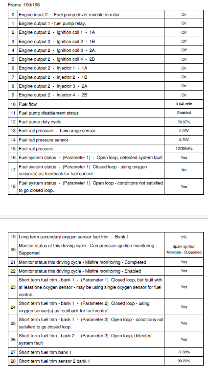

So, after doing a live reading of a few items, nothing to me jumps out and says, "SNAG". I have uploaded a PDF with this reply and maybe someone else sees something. The two images here are revving engine to about 4000rpm and at idle. Fuel rail pressure seems to follow correctly. I am at a loss.

Looking at those numbers the top image if 400RPM and the bottom is at idle correct? If I'm right i don't like the low pressure fuel sensor at 2.9 when at idle. That should be 2.3. I would try replacing that sensor.

This will give a better indication, I believe. However, looking at the PDF with all the readings, the Low Range Sensors voltage is a bit all over the place for similar Rail Pressure readings. And in regards to the O2 sensor at 0% throughout, I am not sure of. I will have to hook it up to our LR4 and see what that one does on it. I went through the engine fuel systems diagrams and I could not find the Low Range Sensor anywhere. Last thing of note is, after a couple short drives today going no faster then 70km/h, after leaving it in parking lot for a hour or so, (shut off), it started with no Engine Light present. I is so confused......
