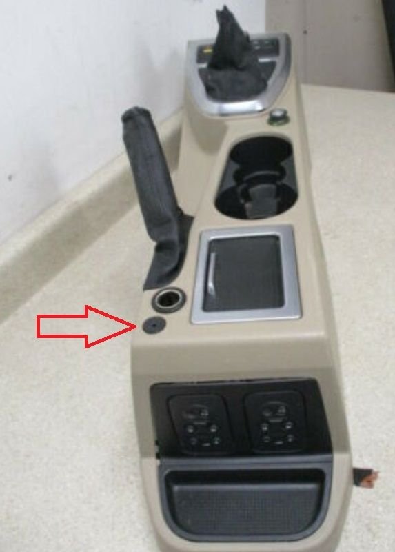

I'm guessing you'd have to remove the center console panel first. Then verify that there is an unused harness connector in the right area which matches the connector on your new socket. Verify the location for the socket and drill a hole (if there's not already one). I'd take a pic for you, but I'm on the road, here's one from google which matches what I remember for my 2008, audio socket in left rear corner...
https://www.ebay.com/itm/27409832999...BoCznUQAvD_BwE
You can download the service manual here, it will have directions on how to remove the console. You might also be find a video on youtube.
https://www.freel2.com/forum/topic10621.html

The aux jack must be a feature for the 2008 HSE vs SE model (I don't have one visible). @LR2driver , exactly where is your aux jack located? LR is well known for covering up add on features for higher models on the lower models?

Ah, I didn't know this was a feature exclusive to the HSE. Using the photo from the eBay listing you posted, it's at the red arrow. This location allows access by front and rear seat passengers.

Actually, no you are correct!!! It is not exclusive to the HSE. I have that but never knew what that was. I thought the might be a fuse or some such under there actually! Duhhhhhhhhh!

Not exclusive to HSE, my SE has one and I use it.
