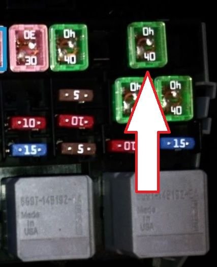

No relay.
Only a fuse to the fan control module.
Removing the fuse will disable the CABIN BLOWER MOTOR.

Are you sure that you have a LR2 and not a CHEVY?
The Blower Motor Controller A.K.A "Resistor" apparently can fail and the fan won't stop.
Looking above it looks like the RESISTOR was already suggested
Did you replace it?
I do like that the CHEVY uses a 40 Amp fuse also and in the video they removed the fuse to stop the fan.
Good luck
