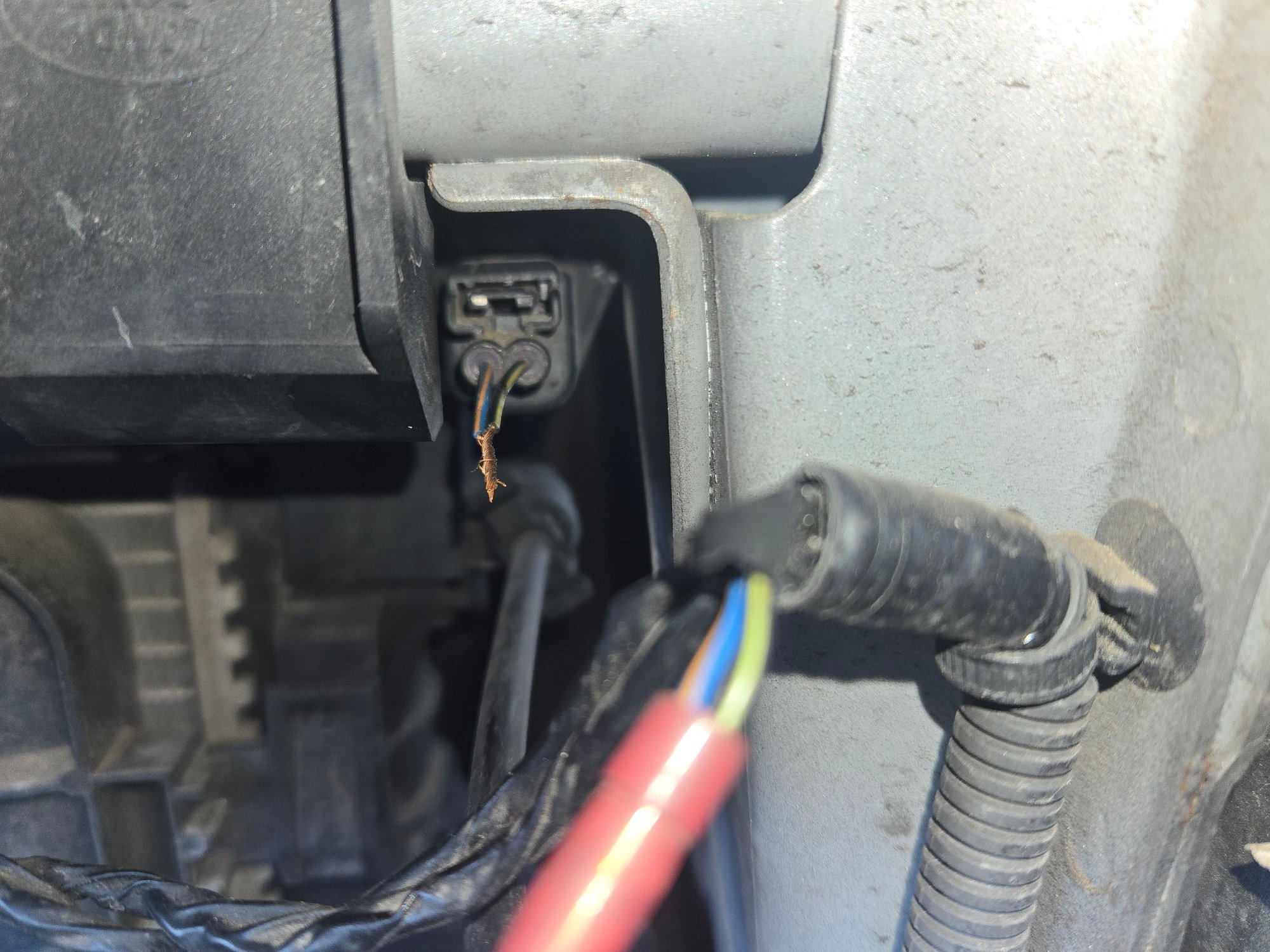

The car alarm goes off randomly...usually early in the morning. Tied off the bonnet sensor and it still does it. Could it be a low battery in the fob? Essentially, I need a new fob, correct? You can't really replace the battery.?

A faulty hood (bonnet) switch is a known issue for an intermittent false alarm. I'm attached the TSB.

[QUOTE=LR2driver;937984]A faulty hood (bonnet) switch is a known issue for an intermittent false alarm. I'm attached the TSB.[/QUOT
Thank you. But if I tied them together (grounding them out), I should be good, right??

Right. That will confirm the problem is the hood switch if the alarm does not go off again.
Afterwards, you can buy the replacement switch at your convenience. Inexpensive and not difficult for DIY replace.

Unfortunately it still.goes off after grounding the wires. Could it really be a bad remote battery?? That's what my mechanic thinks it might be.

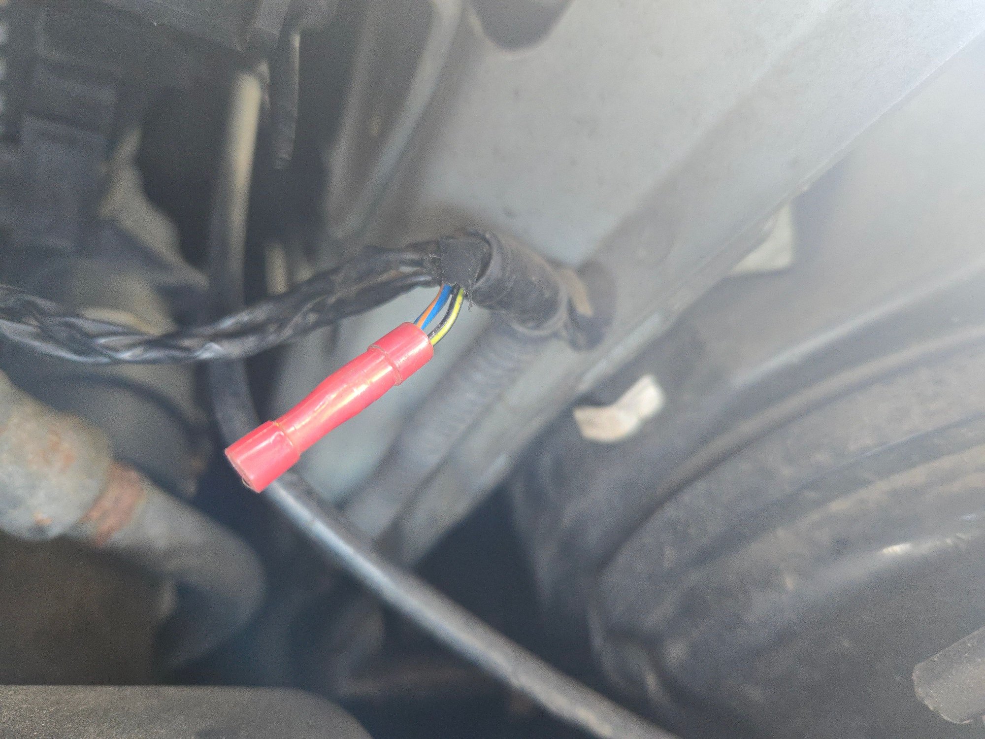

I doubted it too. Here is how the switch is wired now.
